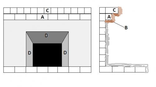

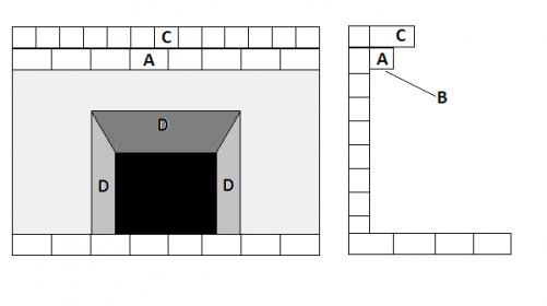

    I plan on using a stone veneer to refinish my fireplace with since removing the fireplace paint and exposing the brick wont look good but I have a couple of questions.
    I'm not sure how I should be wrapping the fireplace, specifically around A and how would I handle the overhang B. C will be covered by an wooden mantle.
    Also how do I handle the corners (D)? Will there just be a lip or is the stone veneer only supposed to go to the edge of the firebox?

    I would install it just as you would with Tile. Use mastic or thinset and use a diamond blade to cut to fit the areas you mention - including the overhang.
    When you hang drywall, you do the ceiling first. Do the mantle underneath first and then cut the stone to meet up with it when you get that far. You might want to mention how thick the stone veneer is.
    Conwaygolfer
    PS: I would also do the ends first, before the front, in order to have the front cover the end cuts.
    PSS: Will you apply grout or mortor between the stones?

      I haven't decided on the type of veneer quite yet, some of the stuff I'm looking at doesn't require any grout. The stone I will eventually pick will not be thick, more like ledger stone.
      So are you saying that I also need the stone to be hung upside down to cover the bottom (B)?
      And does it need to wrap around the edge of the firebox slightly (using corner pieces)?

        I would use thinset and avoid mastic in the heat zone. I have had tile set with mastic close to the firebox on a fireplace fall off as the mastic softened. It looked like at some point it might burn or at least do some noxious out-gassing.
        The pieces on the underside may need support while the thinset sets. Make sure what you install is rated for next to the fire.

          I don't know about the firebox - I was thinking about a hearth near the floor. If it has one, you would want to cover the ends (sides) first so the front stone covers the ends. Same applies for the mantle.
          I also agree with Mr. Bill as far as thinset goes. Being a cement product - the heat would not matter much.
          And yes, the mantle stone will be applied upside down so the finished side is seen. If you get stone that requires grout, there is cement colored caulk which would be easy to apply - but again, watch for the heat from the firebox.
