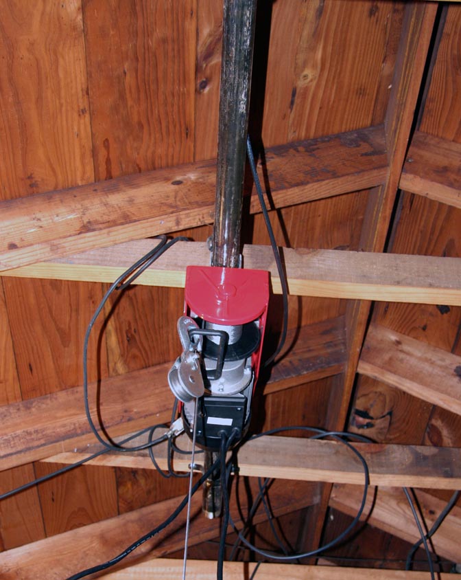

          (2 PICTURES BELOW.)
          This attic has more room in it than most Japanese houses that I had been in. I think I mentioned it before, but I was told that this house was meant to be able to have a second floor attic room. Look at the 8 inch wide pine 3/4 boards used for the roof! Strong! Not like your house that buckles under drywall. Did I mention that the walls in several rooms are the old plaster (concrete hard) with heavy steel mesh as the support on old 2X4s 16 inch on centers.
          The pict with the wires in it - old TV cable. I have got to remove it someday.
          The support pipe is 1 1/4 inside diameter steel water pipe and it runs across 4 beams, and clamped to each one.

                        I used 1/4 inch by 2 1/2 in lag screws and the double holed pipe clamps. (I pre-drilled the holes with a 3/16 in bit. Our hardware store has both double holed clamps (holes on each side), and single holed clamps, which are more or less for just holding the pipe to a beam. But the single holed ones are not good for support other than the pipe itself.
                        The HF clamp system on the top side had 1 1/2 in clearance. So I purchased a 6 ft section of 1 1/4 inside diameter ( 1 1/2 OS) pipe and it fit perfect in the HF support clamps.
