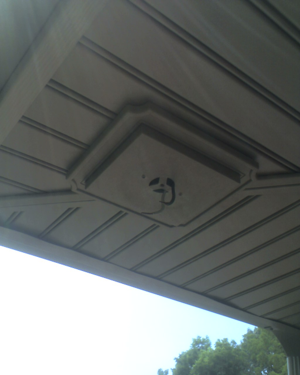

    I have a security light that just quit working and I can't figure out what happened to it. I have checked the light on another circuit and it works OK. When I check the wiring that comes through the soffit I am only getting a very low voltage reading -- in the 1-2 volts range. I checked the SPST switch that turns on the light and I get the same low voltage reading at the switch. I replaced the switch, but it didn't make any difference. I'm getting 120 volts at the breaker. Any ideas on what could be wrong with this circuit and what to do to fix it?

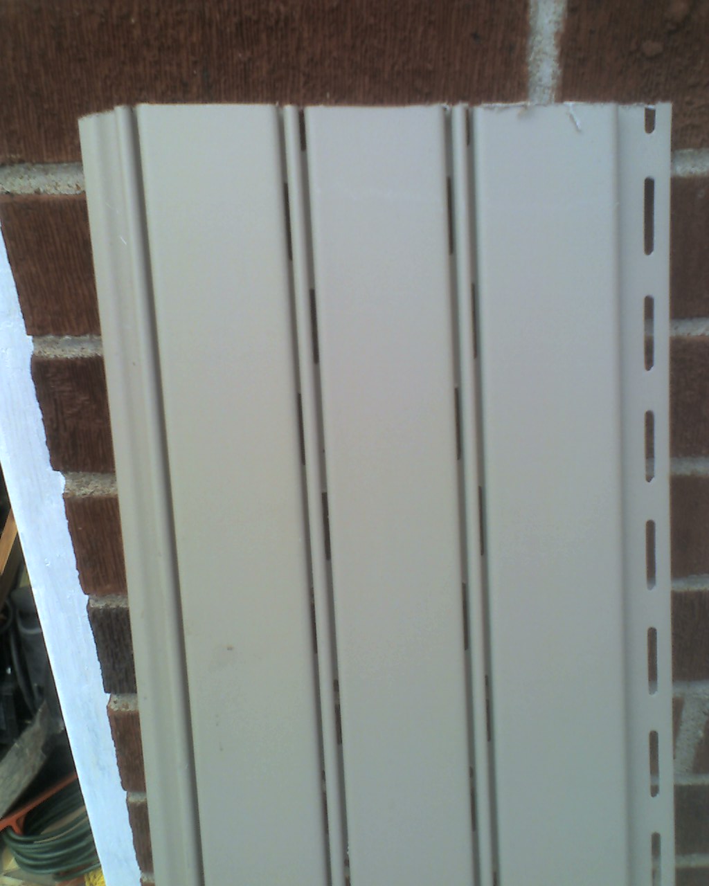

                    I did have vinyl soffit installed, but all they did was take down the light and put it back. The light did work for 2-3 weeks after the soffit installation.

                            The problem with getting into the soffit is that the installers used J-blocks to install the security lights and the inside part of the J-block is nailed in as is the J channel that is installed on the corner at a 45-degree angle. Also, the soffit is vented beadboard that is stiff and very difficult to remove and is held in place by a metal channel and the fascia cap. You can see the two wires from the circuit where I have removed the security light. If there is something loose or damaged, it must be in the attic or in some other part of the circuit. I won't be able to get into the attic until cooler weather.

                              This is why code require's all junctions in a box and be accessible. They broke code when they covered that up. There has to now be a junction that you cannot see.
