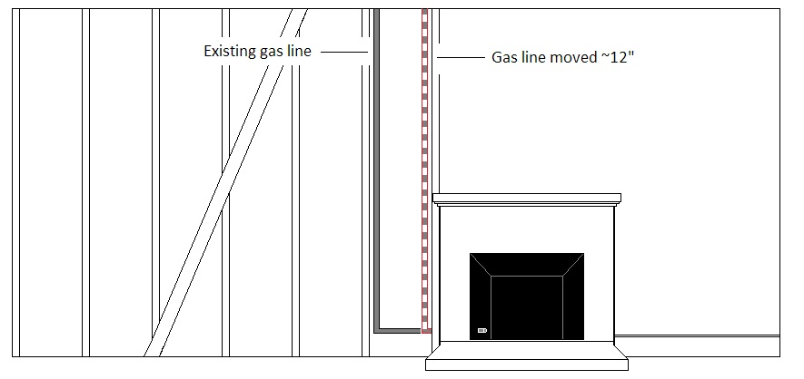

For my laundry room remodel I have come across another obstacle. Right where I want to put a window there is a gas line that goes to the fireplace. I would like to move the gas line to as close to the fireplace as possible so I can add a window and the necessary framing (the window would be no bigger than 24"x24").
Are there any reasons why I can't do what I want (aside from safety reasons)?
