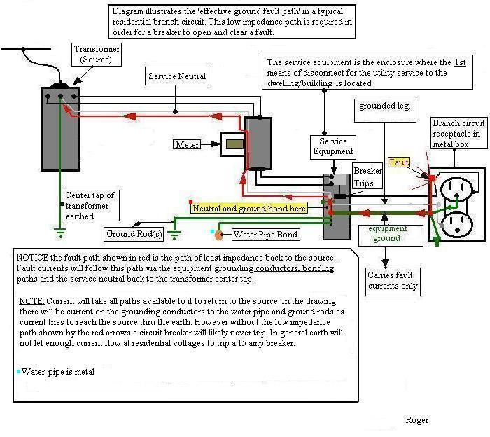

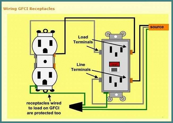

                i have attached some pictures that i have plagiarized off of the net. It was a bit surprising to me how many of the net sites either did not provide all the information needed or information that was completely incorrect.
                The first picture shows the connection paths from the main transformer to shorted receptacle, and the return path on the bonding/ground system.

                the third picture shows the proper connection when there is an available ground.

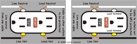

                the last picture show correct and incorrect neutral connections when connecting a GFCI to protect the downstream receptacles

                        yes what your saying is correct, but as long as the down stream receptacles are marked as not being grounded there isn't anything gained by using a GFCI at every receptacle.
                        What I wanted everyone to realize is that the neutral can't be common connected or pigtailed on a GFCI like it can in other applications and still have the downstream receptacles protected.
