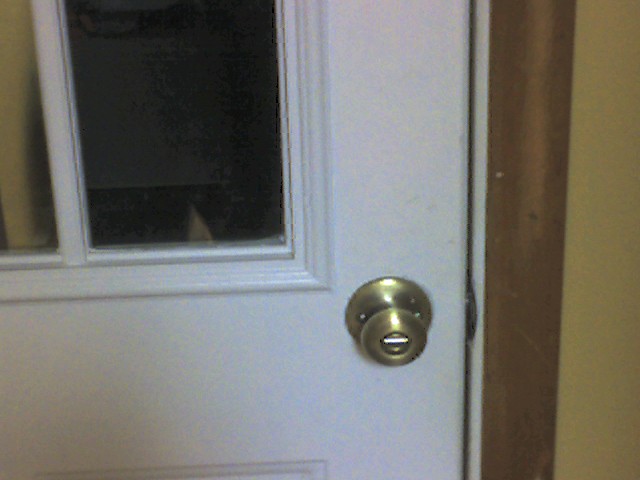

    I'm the proud father of a very active son that just turned 2. His favorite place to go is "outside" and has discovered how to operate door knobs. Anyway, I have a steel door between the "house" and the attached garage. The door has a window in the upper section. While teaching him to push the button to operate the garage door opener seemed like an innocent way to entertain him a year ago, I'm sure that if I don't act soon he will escape to freedom. (Those plastic child-safety gizmos that snap over the door know don't work well with this particular knob.)
    I am planning to install a deadbolt that is keyed on both sides to prevent him from escaping to the outside world (+ they are better for a windowed-door). I'm planning to install the lockset above the knob, as you usually see. I've installed several locksets over the years and have the proper tools, so that isn't a problem.
    My question is: Is the part of the door between the window and the edge reinforced, or will it just be a metal shell with insulation in the middle? I don't really want to start drilling a hole for a lockset to discover that I can't put it where I'd like to - and ruin a door in the process.

    Of the ones I've drilled, there was a substrate there. There should be, especially if it's an exterior door. It's common to install deadbolts. To be sure, you could drill a test hole on the edge where the bolt would be positioned.

                In answer to your original question. Yes every door that I have drilled into that was steel or fiberglass had a plug for both the keyset and deadbolt. But if you drill too high it's often just the skin and foam with a solid banding along the edge of the door. If the door is a name brand door you can look on their web site for a diagram of where the plug is located. Often a tag or sticker is located on the hinge side of the door or the top giving manufacturer and model number. Baring that measure the location of the holes on a predrilled door at the Borg for a save location to drill. If you can find the location of the plug then putting the deadbolt as high as possible will keep it out of reach for another week or two.

                          (2) there is nothing between the glass edge and the door edge but
                          some stryofoam filler.
