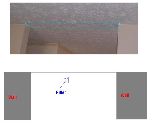

    What material for this project?
    I'm wondering what is available for this small project.
    I have a 4 ft long stretch of ceiling across a doorway that is right in the center of the house. They apparently did not put in enough nailers and there is virtually no support for the drywall across much of the span. There is only 1 truss going through the area and the seam has cracked over time. I tried last night to put some screws into the areas where there is support but there is a 2 ft section at one end that has nowhere to fasten it.
    So, I have decided to put up a piece of white primed wood or maybe some of the white PVC board and trim the sides with some cove or quarter round. There are ending walls at both ends and they are about 5" wide. But I need to go about 3/4" wider to properly catch the section that has no nailer.
    I'm hoping it won't be too noticable after it is painted the same ceiling white as the rest of the ceiling.
    Should I look for door casing that may be 5" wide? What else is available that is 3/4" x 5"?

                Yea, that is a good way to go. I'll consider it. However, that won't completely solve the problem. You see, the section that has no support is at the edge of the wall and it still would not be supported unless I ran some trim along the edge where it meets the ceiling. That's whay I was going to use a 5" wide filler and trim the sides with 3/4" for support past the wall edges. If the seam were in the midde it would simplify things greatly.

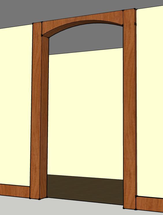

                  I was thinking about this some more... trying to figure out a way to make this look less conspicuous.
                  What if you trimmed the whole door out with some nice wood trim?
                  Rather than making it look like a repair, make it look like a decoration.
                  A really nice wood arch there would look pretty cool.
                  So, in my mind, I am seeing a nice gentle oak or maple arch at the top of that door - 5 inches wide, 5-6 inches tall on the ends, 2-3 inches in the middle. Trim both sides of the door, and perhaps even the inside surfaces, with the same material, maybe 1x4's for the sides, floor to ceiling.

                  If the trim in the house painted, you could even make it out of that type of trim - but, I am a naked wood zealot, so I'd put stained/clear wood there anyway...

                    I would do what Dave suggested. Trim out the entire doorway if you do not want to go into the attic. A piece of wood attached to the ceiling that is wider than the wall is going to look out of place and unfinished.

                        I picked up a piece of 3/4" x 5" x 8 ft board at the blue box. For about $12 and a few dollars for a piece of 3/4" cove. Both are already white. I'll put it up tomorrow and post some pics. Then you people can pick it apart.
