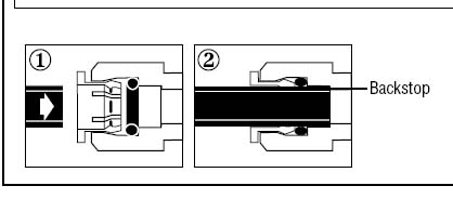

            It just slips into a type of socket. They say to remove it, you press in on the retaining ring and pull on the tube. I didn't try that though!
            Here is what it looks like from the directions.
