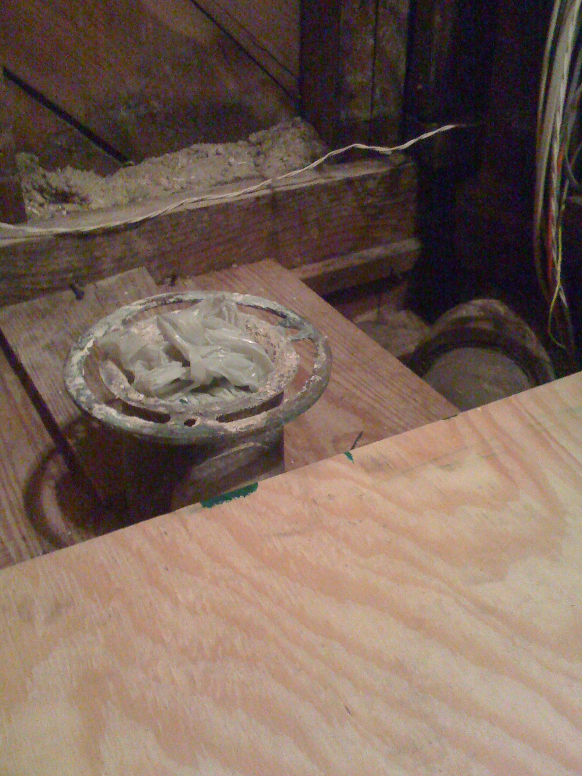

I am remodeling a small half bath. Demolition removed the tile, mortar backing and 3 inches of cement. Very old house, so there is no subfloor. I am putting in a 3/4 subfloor and then durock cement backer board and then tile. My question is about the toilet flange. Does it need to be supported by the subfloor or backer? The flange is cast iron and one piece connected to the drain pipe. Can I drill a hole large enough to fit over the flange and drop the subfloor over it? This would leave the flange unsupported by the subfloor. I could then slip the durock under the flange in two pieces.
Also what should the finished height of the flange be? Is it flush with the finished tile floor, or should it be above it? Thanks in advance. - Kevin
