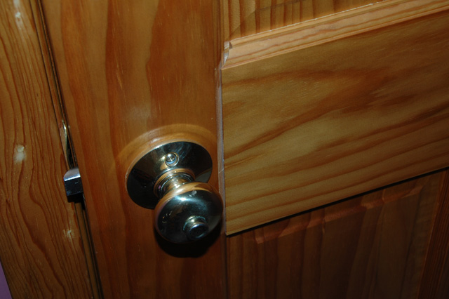

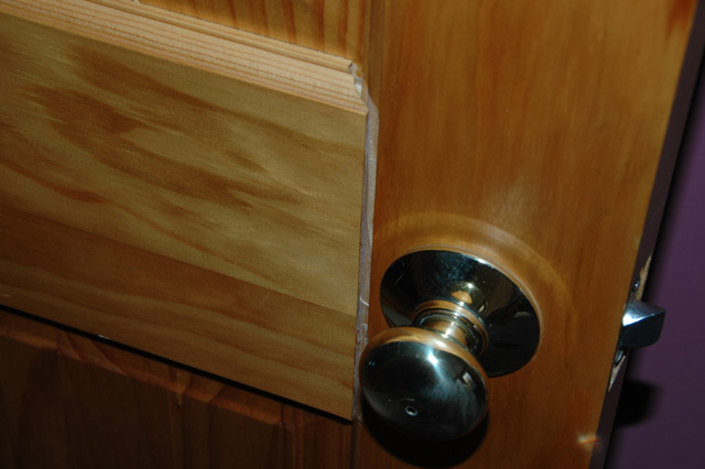

    Moved into this house last September, bought it from the original owners that had it built for them in '95. Shortly after moving in, I noticed that almost all of the interior doors have come apart at one or more of the joints, most are at the joint adjacent to the lockset, but a few are also coming apart on the hinge side stiles. What's weird is none of the corner joints are opening, just the central rail. Some have opened up as much as 3/16", the door will no longer close properly as it hits the jamb.
    These are not cheapy Homey Depot pine doors, they are good heavy solid fir doors that have been uniformly stained and poly'd. The rest of the house is finished with good cabinets and trim, the builder did a very nice job. I find it hard to believe that they didn't allow for panel expansion when the door was constructed, but I suppose it's possible.
    My thoughts on a repair is to lay the door down and drool some glue down into the joint on both sides, then pull it back together with a clamp. Then remove the lockset and sneak a couple of 3" screws into the joint, hiding them in the lockset hole. On the hinge side, I figured I'd bore a deep hole with a sharp Forstner bit, then again hide a long screw, fill the hole with a wood plug.
    Any thoughts or help are appreciated...

    It appears the panels in this frame-and-panel construction are exerting pressure on the sides, as you suggest. The panels should be loose enough to allow movement as they swell and contract with moisture change. Perhaps the panels are too wide, so that they bottomed out in the side grooves of the stiles. Or, perhaps they were accidentally glued on one or both sides. Maybe instead of glue, too much finish buildup? If the latter, you could maybe "break" this bond by pulling the joint together with a clamp. If the former, regluing this joint will not hold.

      One problem with just drizzling wood glue into the loose joint is that they've already been glued once, which means it's aleady absorbed into the pores and makes a fairly poor reglue joint for wood glue.
      If Tom's correct and it's caused by panel expansion, you really need to correct that first. I'd try taking doors completely apart. Odds are good that the glue joints are fairly loose now. It's a bit of work but shouldn't be all that bad and is a lot less expensive than replacing them. Correcting the panels will also allow you to try to get down to bare wood at the joints before reglueing.
      One method of adding extra strenth to the joint is to bore horizontal holes from the edges and bury a big screw into the end of the rails to help hold the styles in place. You can do that from both edges. You'll need to remove the lockset to get at that center rail. You can plug the pilot holes on the exposed edge once done. In addition to pilot holes and screws from the edge, you can also try an angled pocket hole from the top and bottom to strengthen those rails even further....those holes won't be visible.

        This is essentially what I was describing in my repair thoughts, sorry if I wasn't clear.
        I realy hope that I don't have to disassemble these doors, this would be a huge project, there are 12 doors in all that need repair now.
        I think what I will do is use this dry period now to fix one of the doors, while the panels are dry and shrunk to minimum. If the door joint pops open again in the Spring, then I'll know that the panel(s) are the problem.
          I wouldn't suggest taking the doors apart. The joints will be compromised and likely not go back together, not to mention possible damage to the door. It's possible that too much finish has locked the panel in a place restricting its movement. You might first check to see if the panel is loose.
          You could try clamping across the center rail to see if the rail closes up to the stiles. If they do, you could force glue into the joint and re-clamp. Clamping should be done evenly from both sides. Using long screws may present a problem if they are difficult to tighten up. DAMHITK
