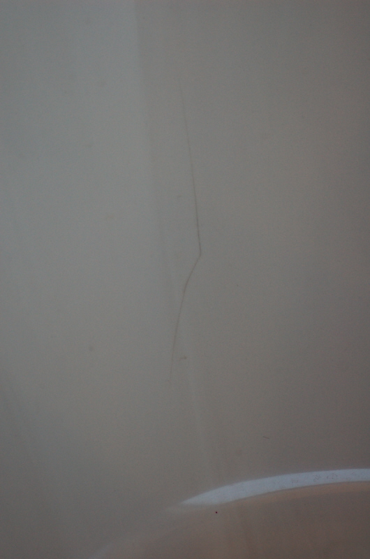

    How do you fix a crack in cultured stone?
    our house is about 4 years old and the we very rarely ever used the tub in the master bath. just last night we noticed a crack in the tub. now, the cultured stone is every where where the tub is, it even extends into the shower stall. so i dont want to replace anything, just looking for a way to fix it. any ideas, suggestion or recommendations?
    edit: the crack is about 8" long
    thanks!
    thanks!
    [ATTACH]11991[/ATTACH]
    I had a similiar problem in my master shower. I finally found a product called Bath Wizard.
    http://www.bathwizard.com/
    Worked better than expected. Choose from White, Bone, or almond colors for base colors and comes with tint to precisely match.

        So you know what caused the crack? Is there some framing members getting wet and swelling enough to put pressure on the side of the tub to crack it?? It could be something as simple as something hard fell on the tub, but might as well find out before fixing the crack. Just a thought.
