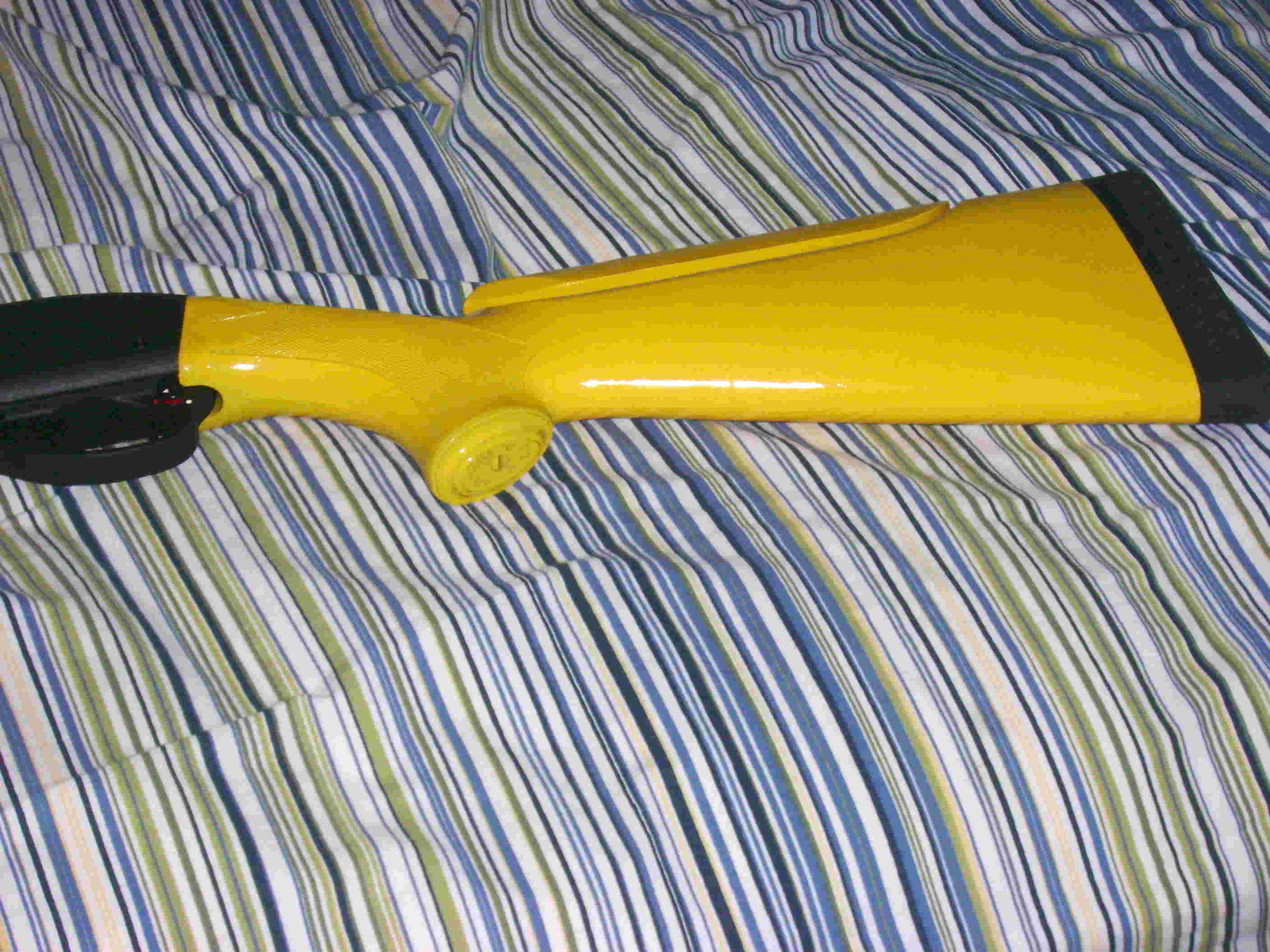

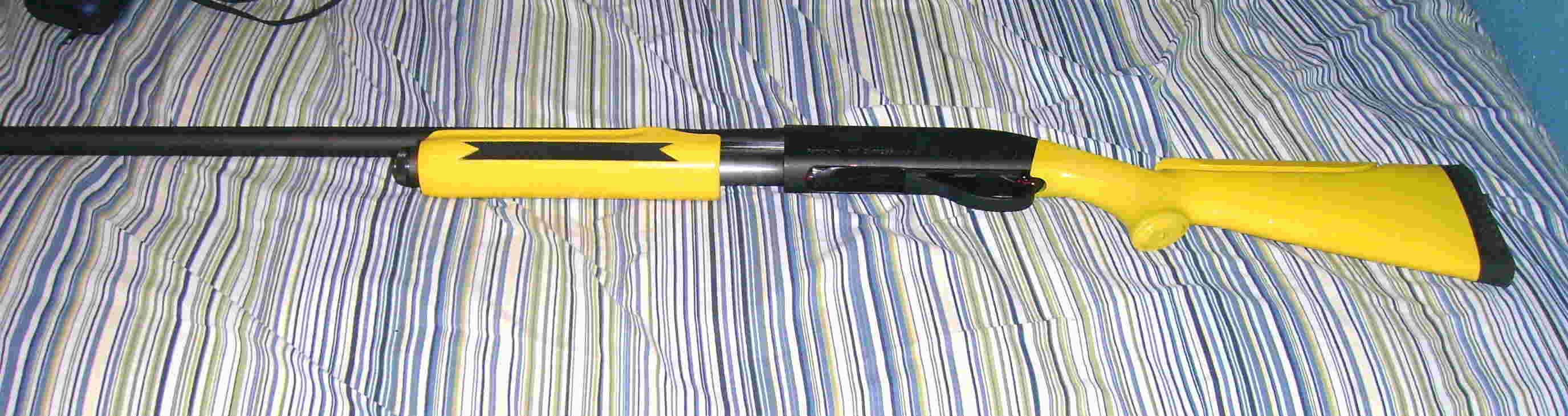

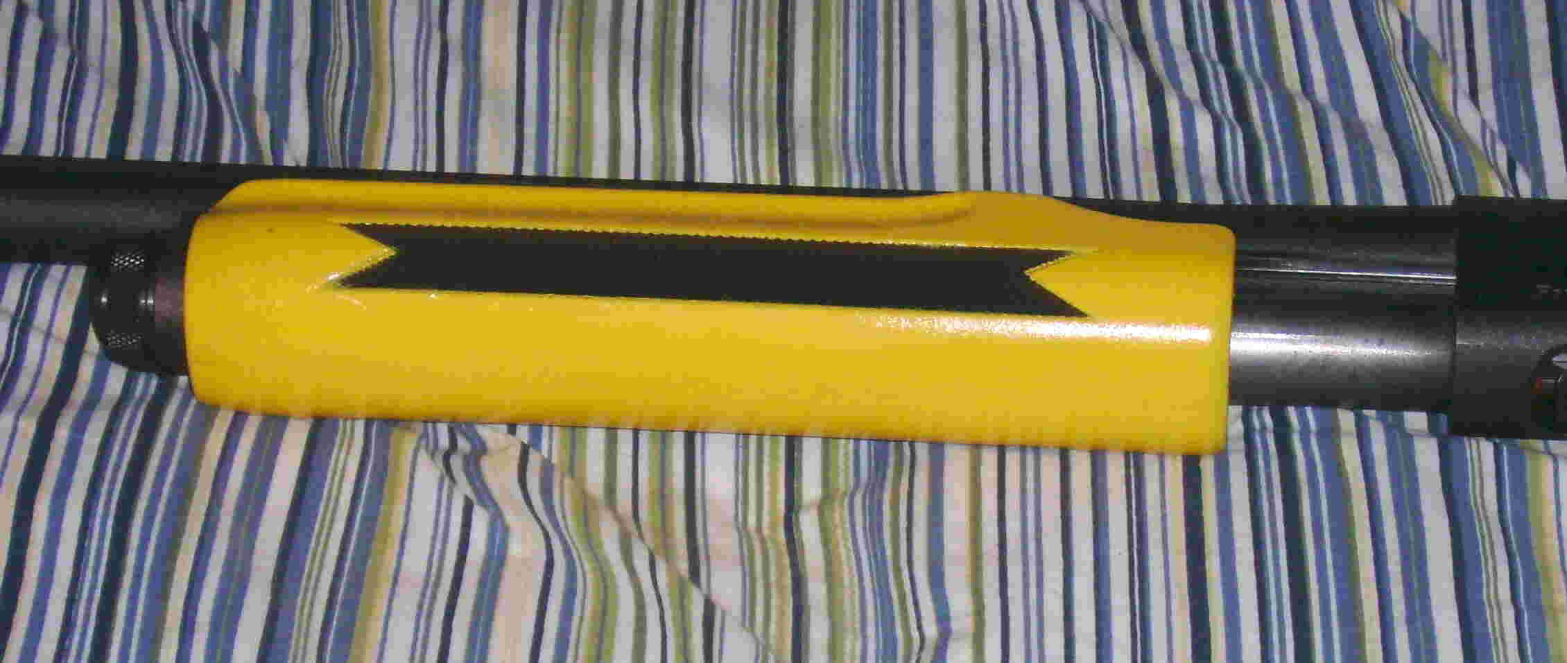

          Here is an 870 we set up for my nephew, he painted the jack west stock
          PM me if you have any questions I can help with
