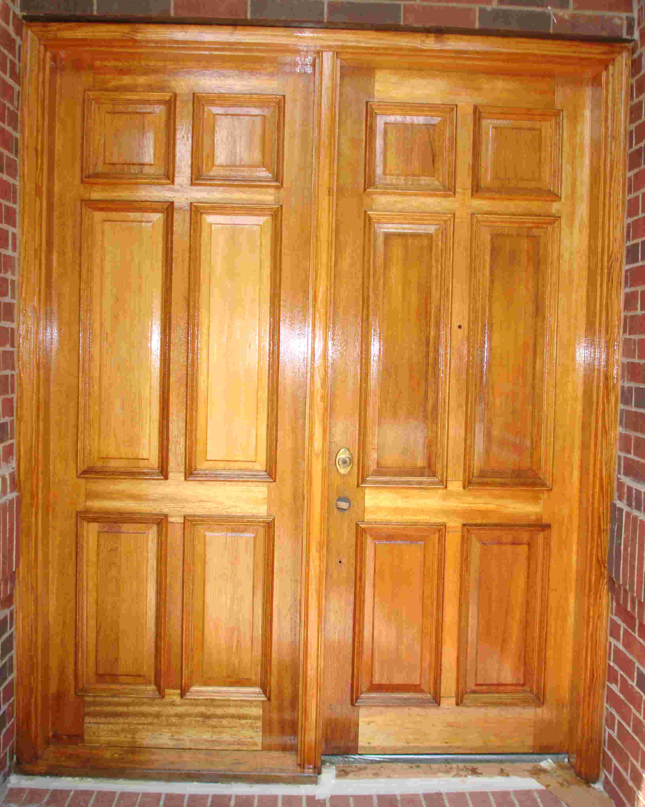

            Yeah, I am familiar with Waterlox on weathered front doors.
            One of my projects this summer was redo an east facing front door. I had tried not to install a wood door in Texas much less east facing, but that is another story. I stripped the doors with a water based chemical stripper (Zip-Strip water rinseble industrial strength) to remove the original poly and most of the stain. After stripping, sanded all of the *^&*&*&^ panels and molding trim by hand. I applied two coats of Waterlox Sanding Sealer and a Coat of Waterlox Marine Finish.
            I am a huge fan of Waterlox. In fact the person that introduced me to Waterlox was Frank Klauz. (see other thread)
            If you have questions about this drop me a PM
            The molding and panels took a lot of time and effort but here are the results.
