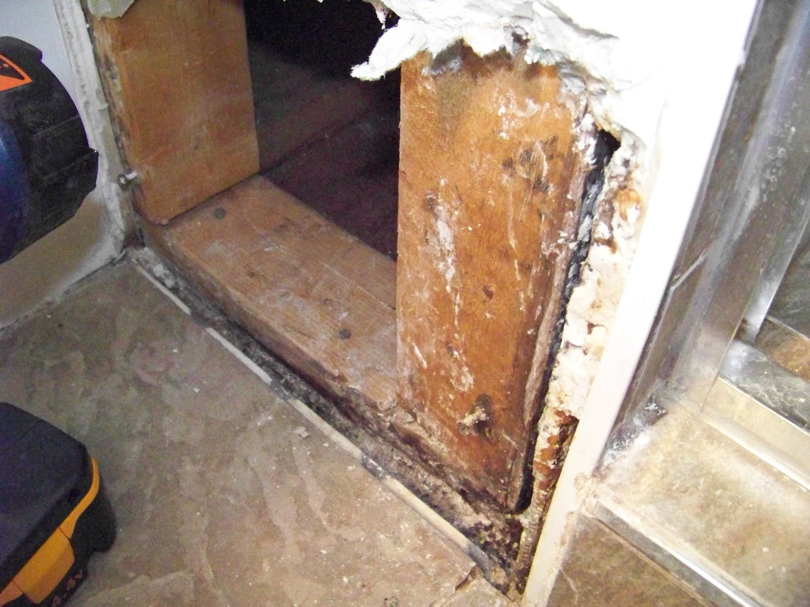

    In our master bath, we have little piles of dirty sawdust (no, not from me) along the baseboards. There are ants crawling all over them, so I assume it's the ants, but I don't know if ants would do that or not.
    This is a second floor bath, if that makes any difference. We had a termite inspection when we moved in 2+ years ago, which came out with no evidence of termites.

      It's carpenter ants, which can be as serious as termites. Unlike termites, they do not actually eat the wood, but remove it to build their tunnels. End result for a homeowner is the same, however. They only chew moist wood, so you've also got a moisture problem. Sorry for the bad news.

              Well, Chris, you nailed it. Thanks, I guess...
              It looks like the shower is leaking from somewhere, or is splashing out. I looked everywhere in the shower, and can see no cracks or holes in the grout or anywhere else--I know, with water it's the holes you never see...
              When discussing the situation with LOML, she says she sprays down the shower with the hand held sprayer, including (especially) the glass doors, so I am HOPING that's it.
              I can't see any water behind the wall, so I figure it had to come from the front, possibly channeled down the drywall end piece--the plastic "ediging" or whatever it's called.
              I was VERY careful, and I did not see any evidence of mold, just wet green board. Nothing appeared discolored and I did not see any spores.
              Next question, some ants were coming out on the other side of the shower. I checked that DW and it's all dry. Would they have migrated to a dry area, or should I gut the whole room? Please God, no...

                  You may also have a leaky shower pan. In older houses, this was an actual pan made of metal or plastic. Eventually, many of them ended up leaking. Nowadays, they're actually like a rubber sheet, and are much more durable. Unfortunately, replacement is a real PITA, and involves re-flooring and re-tiling your shower.

                        I did see the episode of ATOH that showed water damage caused by a faulty door seal. That led me to my overly optimistic diagnosis. I have since discovered a tile in the shower that is "squishy" with water coming from underneath it when I push on it.
                        It looks like I will (AT LEAST) be pulling up some tiles. Is there any hope that this one tile/caulk is bad and causing the whole issue? The tile is between the damaged wall section and the drain, so the wall is "uphill" of the suspected bad tile.

                          So, I have now discovered my "squishy" tile is firmly embedded. I took the grout out around it, and about half of it is soft and mushy, like it never cured--or maybe wasn't sealed properly.
                          Anyway, any chance water could have gotten under the grout and migrated to my troubled area? Yes, I am being very optimistic. I may re-grout it, seal it and test it. I would much rather do that than rip everything out.

                            Did you ever get to the problem of your troubles? The phot you posted up looked just like the same area of my shower though I don't have any ant problems. I just know there's mositure behind there somewhere as the base wood trim shows some SLIGHT discoloration and the paint meeting the trim is starting to bubble.
                            I went over the inside of my show with a magnifying glass and there's nothing that I can spot. No squishy tile(s) either. I wonder if the leak is migrating from elsewhere.

                              Mike, I am sorry to say I have not completely found my trouble spot. I did fix the bad grout and waited a week or so to use the shower. When I tested and looked for water, I didn't find any. After using the shower for a week or so, the space behind the wall is wet again--but not nearly as much.
