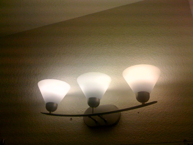

              Well, here it is. It wasn't as hard or scary as I originally thought. In fact, it's quite easy. I won't be too scared about putting lights in the built-ins anymore. And changing a few other light fixtures around the house.
              • mschrank
                • Oct 2004
                • 1130
                • Hood River, OR, USA.
                Good work, but I think it's upside down! I recently replaced our bath light fixtures with some similar to yours....the LOML and I went 'round and 'round whether they should point up or down.
                      Heh.
                      I actually installed it originally facing down, but it was too bright and the shades were a bit lower than the top of the mirror. At some point, I want to put moldings around the mirror to frame it, like in the recent Workbench issue. I think it looks pretty nice the way it is now, though.
