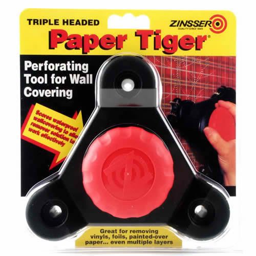

                  I have had great success with the Paper Tiger and any enzyme based stripper. Works great on any type of paper. The Paper Tiger can be found at HD.

                        Another vote for the Paper Tiger. I won't attempt wallpaper removal without one.
                        Chances are, if the paper was applied within the last 10 years, it is a pre-pasted paper (no guarantees, though), and these little gizmos work wonders.
                        Don't be shy about how many times you run it over the surface; the more perforations the better. It's a whole lot easier to make the wallpaper look like swiss cheese than it is to have to scrape & peel areas you missed.

                          Ditto on the "Tiger". Just got done taking paper off walls in a bedroom that is 20' x 25'. Paper was prepasted stuff that is called "anaglipta" (sp), anyway it is a heavy embossed paper that is great for hiding wall imperfections. It all had to come off, probably would still have been at it if not for that handy little tool.

                            I've done about a dozen rooms with this stuff and it works unbelievably well. I will say that I liked the paper tiger scorer better than wallwiks, but the sheets make a big difference.

                              i used the paper tiger, Dif fast acting paper remover (red, the blue kind although fume friendly, was worthless), water, and a boat load of elbow grease. Then I had to wash the walls and sand them and fill in some minor indents from the paper tiger. It took me 2, 9 hour days for a lousy 35sq ft powder room.
