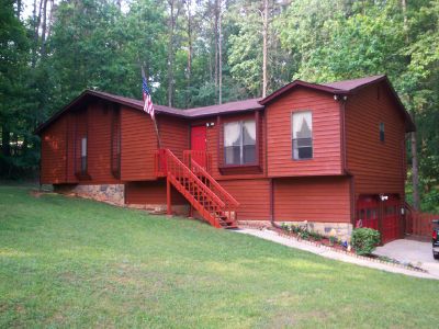

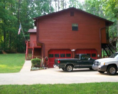

                      I have read what Mike has stated about using only bleach. 20 years ago I tested different chemicals on scrap wood to find a solution to how I wanted to treat my cedar sided house and deck in the future.
                      And I will agree that pure bleach will rough up and "pit" the wood if you use too heavy a concentrate and leave it too long. So will getting too close with the spray from a 2400 psi pressure washer even without bleach having been applied. And that is why I stated basically to get it on and get it off by flushing throughly (and I emphasize throughly) immediately.
                      I have never used the oxilic acid after as suggested by the authorities "to be". But I do watch my mixture of bleach carefully.. and I do maintain the proper distance with a pressure washer (this requires going on a ladder on my home to get high points and I have high points).. and the results are what you see in the two pictures I posted.
                      I have had 3 paint contractors ask how I kept the cedar looking like the day it was applied? And I personally believe that the answer is I get the mildew off before I stain and I apply the stain with a 4" brush. It is brushed on heavily till it runs, then I move to a fresh area. When spread on that new area, I come back and back-brush it to take away any excess that didn't penetrate the wood.
                      My personal belief is that most contractors I have spoken to can't get the same results by spraying or rolling it on even if they back-brush it at that point. What you get is like applying lip-stick. Looks good when applied... but it ain't gonna last long under conditions that be.
                      I have no intention in getting in an argument about using pure bleach that is cut properly and then flushed throughly without using the mentioned chemicals afterward. This is the method I use and the results are in the two pictures I posted after 5 applications (once every 4 years whether needed at that time or not). The picture says a thousand words and I will let it speak for itself.
                      The rear deck was put together hastilly as cedar or pressure treat was not used.. regular yellow pine. Both house and decks get a large exposure to the Georgia sun and both are faring well using the method I have described... but after determining that method by testing prior to adapting 20 years ago. BTW... the trim gets treated with Porch & Floor paint and leaves a very hard finish.
                      I am certainly not a professional painter or wood-worker... but I feel I can get just as good or better results as both in some cases because I don't have dead-lines and have the time to do a job as through as I personally feel it should be done, regardless of how long it will take. Quantity doesn't always relate to Quality! If it did... it took Michaelangelo 3 years to paint the ceiling of the Cistine Chapel... h*ll, I could have knocked it out in 15 minutes with a roller.. "So what" if he got the best resluts. ha.. ha... ha..ha..ha..
                      Just my view from my deck....
                      Ya'll have a good day!
