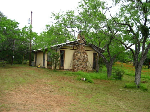

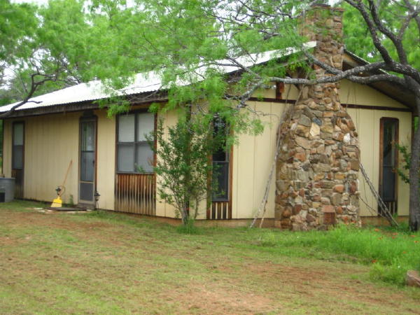

    Here's a couple pics of my In-Laws house in the Hill Country of Texas...down by Llano. We went down a couple of weeks ago on vac...the wild flowers were so high I was worried the pick-up was gonna set them on fire.

    The house was built about 25 years ago when my In-Laws went hunting and
    just to get away from it all. They did it all except pour and float the pad and well and septic system work. The fireplace is made from rocks picked up on 6 acres they own....its even more beautiful inside.

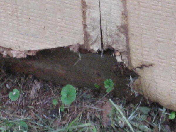

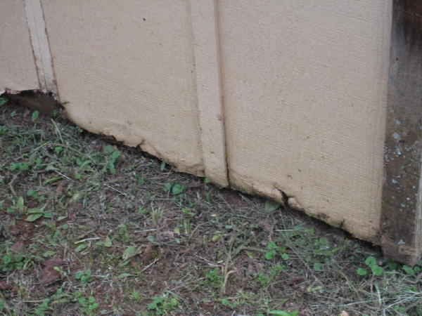

    But the problem is the siding on the outside of the house...

    as you can see its all rotting at the bottom. It is just whats called masonite siding here...paperboard is what its called up north.
    My Father-in-law is talking about just cutting off the bottom 2 feet and residing with the same but would be open to other suggestions. I think it all needs to come off, soil graded away from the bottom and completely resided.
    I come up with $1500.00 to reside it and the soffits and facisa with Hardiplanks for materials...even adding the inevitable 30% over budget we're still $2000.00.
    So any ideas and suggestions welcomed. Anyone with hardiplank experience wanna share any tips??? And just how far off the ground does Hardiplank need to be?? they say 6 inches but it is cement???

            From the builder end of this:
            1. Missing flashing behind the masonite. The sill plate/sheathing should have some kind of flashing overlapping the joint at the slab. The top of flashing should be installed behind the tarpaper/tyvek/etc vapor barrier.
            2. The masonite looks like its installed 4" below the sill plate. You really only need 1" of overlap if its flashed and closed up properly. That ends the need for regrading. Looking at the first picture it looks like you have a decent slope away from the house anyway.
            3. It doesn't look like any gutters are installed. That also has a great impact on shedding water away from the house. The rain is splashing up on the bottom 2-3' of the siding now.
