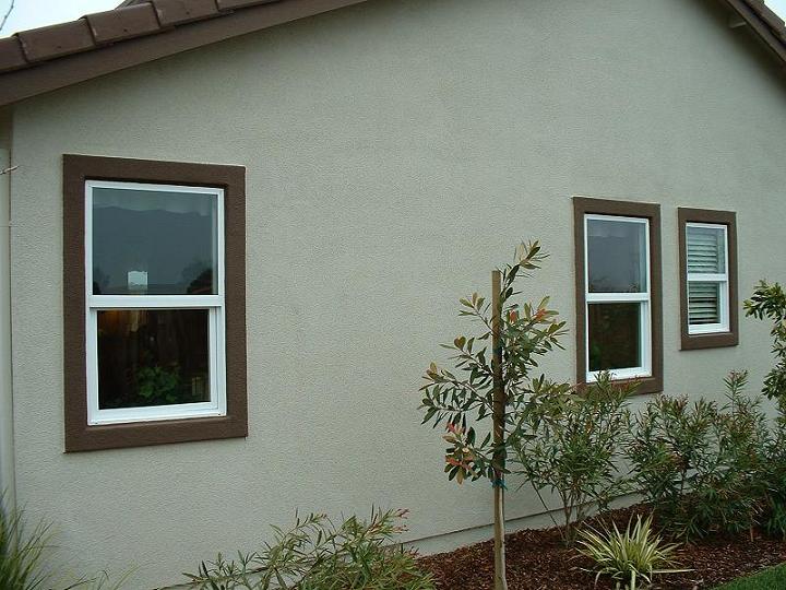

    I'm going to be removing and installing a window of a different size as well as installing two new windows. The only part of the project that concerns me is the stucco (mainly because I'll be remodeling on the 2nd story).
    I'm looking to add trim to the outside like the pics below and I'm not sure how to do it (three layers? one?). Also for one of my windows I will need to redo a lot of the stucco since I will be replacing the existing 3'x5' window with a 4'x4'. Sounds easy enough, except for some reason the outer wall is only composed of the barrier, metal, lath, and stucco! Nothing else! no osb or anything. My other concern is making sure I get the flashing right (or what ever it is I need to do to make sure the window trim is properly sealed).

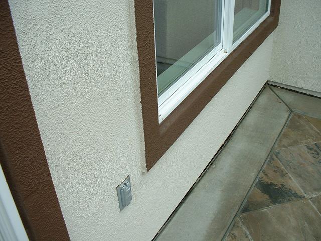

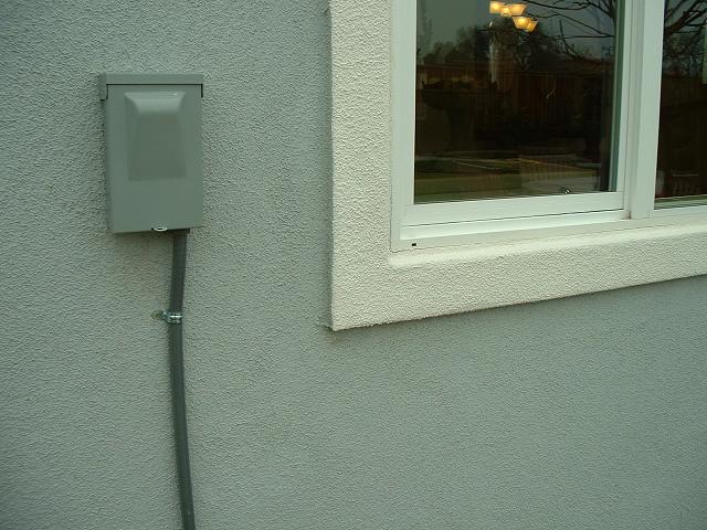

      As far as the bump outs around the windows, our contractor used a combination of wire mesh and styrofoam to get the 3D look around the windows as can be seen in the link below. Check around the garage doors and around the front door.

          The border around your windows looks remarkably similar to mine (sorry, no picture). Our exterior walls were done as follows:
          --1" thick styrofoam applied to the sheathing with mastic, covered with fiberglass mesh and then secured with roofing nails. 2" thick styrofoam was applied around the windows in the desired width, also with overlying fiberglass mesh and roofing nails. The foam was your basic white stuff available at Home Depot.
          --Mortar scratch coat applied over the fiberglass mesh.
          --color acrylic (Parex, in our case) coat applied over the scratch coat.
          I've tried to repair some dings in our stucco and the hardest part for me was getting a good texture match. Color can be matched exactly by stucco suppliers if you give them a sample.
          Hope this helps.

                  What most of y'all are talking about here, and what appears to be on the house in the OP, is NOT traditional three-coat stucco. It's what is known generically as Exterior Insulation and Finish System, or EIFS (often pronounced "eefs" although some people, myself included, spell out the letters). "Dryvit" is one well-known trade name and many people call all EIFS systems that, regardless of manufacturer (i.e., like "Kleenex" or "Xerox").
                  The system consists of rigid foam insulation, applied in sheets to the structure with special large-headed fasteners, then a layer of reinforcing mesh, then a scratch coat, then a finish coat that is intended to resemble the texture of stucco. But that superficial finished resemblance is the only thing the two systems have in common.
                  EIFS originated in Europe, gosh must be 40 years ago, as a way to retrofit insulation to older buildings that were terribly energy-inefficient but otherwise too good to tear down. One of the attractions of EIFS is that it can be artfully shaped into all manner of designs easily, since all that is required is to cut and build up additional layers of foam as necessary. That is (I'm pretty sure) how the window surrounds pictured in the OP were done.
                  These two characteristics -- the ease of adding insulation, the detailing possibilities -- gained EIFS quick early acceptance as a sort of miracle material BUT as time went on there were a lot of problems with water infiltration and expansion control due to bad detailing, resulting in endless lawsuits to recover the costs of the damages. In many cases the damage was akin to termite infestation: on the surface, everything looked fine; below the finish coat, all h3ll was breaking loose. The recommendations for acceptable detailing have changed significantly over the years as the potential problems with EIFS became better understood. By definition, virtually all these problems will occur where the EIFS materials adjoin something else: window and door openings, the building's roof, the ground. These are historically the same places where most water problems occur and a badly-detailed or -installed EIFS job will virtually guarantee them. We therefore don't much use it on our projects anymore except for superficial and/or non-critical areas like signage, or for portions of the building where the material can be isolated easily and kept away from the problem areas (for example, the triangular gable ends of a building, above the brick line).
                  Because of all this, EIFS is not something a DIYer should attempt, especially around windows or doors. Many if not most reputable EIFS manufacturers will not sell the materials to anyone except factory-trained and -authorized installers. Done right, it's a great system. Done wrong, it's an absolute nightmare.
