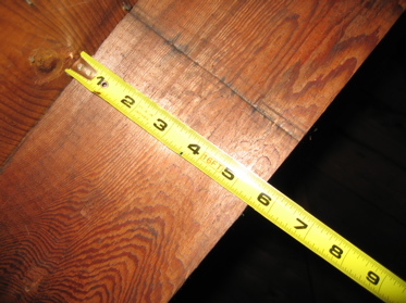

    I am finishing an attic space. My rafters are 2x6 with 1x sheathing and slate roof tiles on the outside. My plan is to use clipvent and rigid foam to create an air channel. In order to get adequate insulation in the space it has been recommended that I add sleepers to the current rafters. What is the best way to add sleepers? My thought is to add a 2x4 on on edge and then secure with squares of 1/2" ply or osb. I thought 5"x5" squares every 4' on both sides. Does that sound right?

    I take it you want to extend the width of rafters so that more insulation can be put in. I would chuck a 3/8" bit in a drill, mark 1.5" depth and drill blind holes roughly every 2' into the edges of 2x4s. Then, use 3.5" deck screws in the holes to fasten the 2x4s to the rafters.
      Those ply gussets, construction adhesive and a finish nailer might be faster than the screws.

        Scorrpio, yes that is exactly my intention. 2x4 on edge to add depth and more insulation. This is the recommendation I received from 2 contractors. But now one told me exactly how to do it.
        Crokett, I was thinking of a framing nailer instead of a finish nailer. I have both. HF framing or PC 15 gauge. Would the framing nailer be overkill? Would all of those larger holes weaken my rafters? Would 15 ga with construction adhesive be enough to hold the 2x4 and weight of sheetrock, tape etc? And do you think 5"x5" ply is about the right size. Is every 4' enough or should I go every 2'?
        Does anyone have any experience with either method? By the time I cut all the plywood gussets, I wonder if I am using the same amount of time as scorrpio's suggestion to drill and screw.
          The construction adhesive is holding the gussets and 2x4s. The brads are just there to hold things until it dries. Also put glue along the edge of the 2x4. Considering when I mistakenly glued a 2x4 to my basement floor last year and the 2x4 split before the glue let go I'd say the glue will hold.
          The difference between cutting gussets and drilling and screwing is most of your time is spent in the shop cutting gussets and fixing them to 2x4s. With drilling and screwing most of your time is spent in a possibly cramped, probably hot and certainly dirty attic. Your call.
