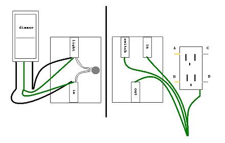

        At the main receptacle three sets of wires come in, one for the switch, one from the breaker and one to another receptacle.
        Do I just create a new lead and pigtail that with the wire coming from the switch and the breaker (black) and then do the same thing with the white wire?

          seems that would be correct except you dont need to pigtail the black if the outlet is no longer switched,---pigtail the white(common) and run to lamp new romex, and wirenut the black wire that comes from the switched side of the switch to new romex-this would have been from your switched outlet. Im sure your turning off the breaker before you do this,

            This is what my setup looks like:

              It's a matter of taste but in that situation I hook the leads from the breaker to the receptacle, then hook pigtails to the other 2 terminals and attach those pigtails to the wires going to the other receptacle and the light switch.
                Sounds good, thanks!
