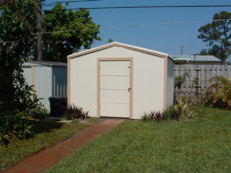

        I wouldn't opt for a kit. Get a plan and work off it. It gives you total control over everything.
          I had to build a shed after Wilma. It is a 10' x 12' all from scratch. One pic is in the framing stage and the other is complete. Used 2x4's, 3/4" plywood floor on PT framed floor joists. Exterior is T-111 and the roof is some really cool stuff:
          http://www.ondura.com
          Cost for all was about $800.00
