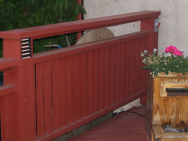

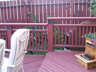

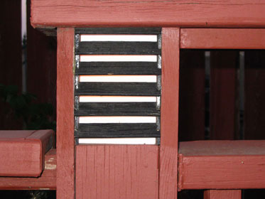

                            Long time lurker, first time poster! Some years ago one of first WW projects (before owning the saw) was the deck railing complete with lights. Idea came from a Wood Magazine, and since I am an Electronics Tech by trade I made some mods to the magazines idea for lighting.
                            Basically each 4x4 post is wrapped by 1x4's that are longer than the top of the post. This leaves a nice square area for installing lamps. I used an old X-mas light set that uses the 7W incandescent bulbs mounted inside on the top of the 4x4. Routed slots in the 1x4 post wraps for the wiring and ran most of the rest under the cap railing to the switch on the last post. All wiring is 120 VAC, but low voltage lamps would also work. Louvers were made without use of the BT as well. I could do much better today but this was a learning project.
                            Attached are some photos of the result. Note the white plastic diffuser lens serves dual purpose. Keeps spiders etc out in summer and snow out in winter. Temps in Calgary often reach -25 C in winter.
