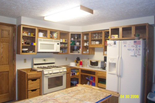

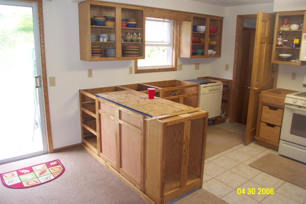

                    In process..
                    Last fall we took our kitchen layout to a Box store and they did a workup for us with Kraft Maid cabinets. The total for the cabinets with no extras was a little over 6K. With pull out drawers/trash can and other options the price went higher. They did however give me a nice drawing and 3-d views of our design! I started at the end of November building the upper cabinets. I don’t have nearly enough room to make/store a complete kitchen. I installed the uppers right after Christmas and then went to work on one side of the room where their were no lower cabinets. After they were installed I built the remaining bases. Two weeks ago we tore out the last of the old ones (including the sink!!). The new ones are installed and the counter people were out and made the template. The new counter will be installed when I get back from vacation. I still have 17 drawers and all the doors to make….next winter. We ride bikes and travel in the summer. So.. Was it worth it?? So Far I have $2100 in materials and $800 in tools . Besides being a lot cheaper I have all the options and no fillers/wasted space. The material cost includes all the electrical and plumbing supplies also. The best part is the satisfaction of building them myself. YES it is worth it to me.
