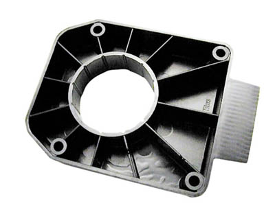

                      This thread is very timely indeed...
                      I also am in the process of a kitchen cabinet remodel (kinda learning as I go). I ordered a box full of the Titus cabinet levelers from Woodworkers Hardware, and have been unsuccessful in getting much of anything in the way of install instructions.
                      The one part that really has me confused is the 'Leg Fix Block' as shown
                      I'm not entirely sure what the 'tab' is used for.
                        The tab is to transfer some of the load from the base to the carcass sides. This is especially useful if the cabinet construction is by the usual flat-pack method of alloy dowels and camlocks, otherwise the alloy dowel is carrying the whole lot. I'm not saying they can't carry it, but it's a great idea to give them all the help you can - hence the tab.
                        The tab is to be faced "outboard" and held back just a hair from the outside of the carcass sides, both front and rear. If used as part of a flat-pack kit, you'll find locating holes that position it correctly. Otherwise, just as described.
                        You can also get base leg units that span across a pair of adjacent cabinets, but I don't use those, as it cuts down on the number of legs overall.
                          HTH, Stan.
                          Ray.
                          Well now, that makes perfect sense...
                          Thanks much.
