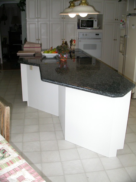

    i have a "what is the best way" question with respect to removing the lino & floor in my kitchen. here's the problem: there is an "island" in the middle of the kitchen - it, of course, sits right on top of the flooring i want to remove. unlike the flooring that butts up against the walls of the kitchen and is easy to rip out, this flooring goes right "under" the island.
    when i am ripping up the flooring, what is the best way to proceed when the flooring begins to go under the island? i have to cut away and remove the floor up to, but not under, the island. is there some kind of saw or tool that will allow me to cut a clean edge around the exterior of the island while leaving the rest of the floor under the island completely intact?

        phil and alan, thank you both for your prompt replies. alan, i checked for a kickboard but for most of the island the cabinet goes right to the floor, so that was a good idea, but in my case it won't work.
        phil, i checked out the toekick saw and that definitely seems to be what i need - i didn't even know there was such a thing. according to the description, it should do exactly what i need to do.
        by the way, someone else suggested that i should just move the island. try moving this:
        that's a 12' x 4.5' hunk of solid granite on top of that island - it ain't goin' anywhere
