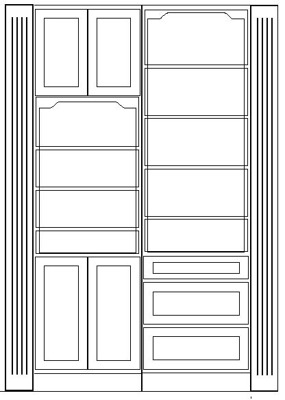

                Ok. Picture is attached. Again note that the fillers are 3/4" thick. They are not columns (which might make the installation easier?).
                • kmk
                  • 415
                  • .Portland, Oregon
                  BTW I'm using pre-finished materials so they need to fit tightly. painting and caulking are not options.
