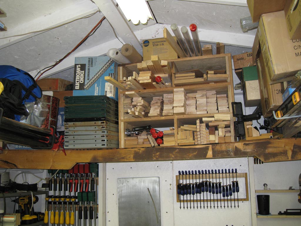

                          I'm not one to thread-jack, but the title seems to perfectly state my question.
                          I have a 12x12 shed, and can think of two ideas for storing cutoffs - over my head, on 2x4s bolted to the joists and studs, or vertical against a wall. It's a low ceiling, so the sheets would be oriented short side down.
                          Which one would be better?
                            I put my sheet goods vertically against a wall, but I try to keep them as flat as possible. I have to be careful about not letting them fall back on me though.
                            I made an overhead rack in my garage for storing lumber and sheetgoods that fits between the door and the ceiling. It was a great use of unused space and it freed up a bunch of wallspace. It is a pain to access though. More often than not, the piece I need is at the bottom of the stack. Another thing I don't like about the overhead storage is that long items can be difficult.
                            In my shed I've got some overhead storage for lumber cutoffs. It's about 24" deep and fits right above the doors in the gable roof space.
                            • Larryl
                              • 284
                              • Lorena, TX, USA.
                              • Grizzly G0478 Hybrid
                              Erik - wow, you are definitely utilizing your space well. Nice clamp racks.
