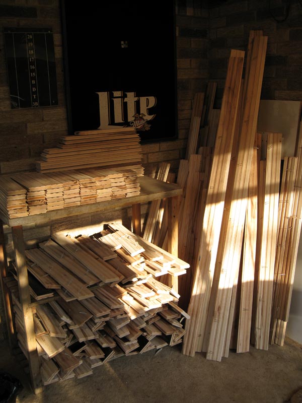

    I just picked up a whole bunch of 3/4" x 3 1/2" maple flooring that was removed from a condo remodel we are doing. I think I got all the waste from a 12'x15' room, and a bunch of pieces from the cutoffs (sans staples) that replaced it.
    I spent a few hours last weekend removing the wire staples that were driven though the tongues. It was a real chore. The wire is pretty malleable and the staples are really stubborn. I got better results when I clamped a pair of locking pliers to the wire and tried driving the staple out enough to pry it from the other side. More often than not the fastener would bend over then back out. Is there a better way to remove them?
    I was thinking of finding a narrow tube that would slide down the wire to keep it from bending over and sliding a punch or some small diameter solid rod down the tube and backing the staple out with a hammer. I need to pick up a Fubar to pry them from the other side.

        Thanks for the ideas. I want to get a bunch of boards out of theis material so they'll have to come out one way or another. At least the ones on top of that rack in the photo have no staples. I'll be sure to spec 6" flooring and nails only next time.
        Man, that's a lot of staples. I've got a feeling I probably should have let sleeping dogs lay.
