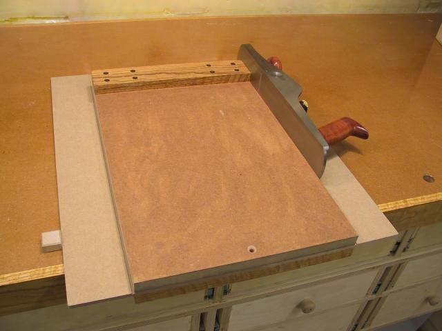

        • RodKirby
          • 3136
          • Mao Shan TSC-10RAS
          I made this about a squillion years ago - seen good service
          Downunder ... 1" = 25.4mm

            Rod, that is beautiful. Is that a stop block thing at the end of the SMT fence that is missing from the breakdown shown in the last picture?
            • RodKirby
              • 3136
              No - It's the "notched" end of the plywood fence...

                Gwyneth and MPC- I was thinking of the hand plane, but these pieces are smallish and I will need to clamp the 1" thick end and plane the 2.5" long X 2" tall end. I was trying to figure out how to plane them. What is a "shooting board"? Is that what you do to people like me who don't have a clue what they're doing? haha. Seriously though- I've never heard of it.
                Rod- That is an ingenius idea. That should be in a woodworking magazine if it isn't already- I am sure it could be addapted for just about any kind of miter/rip fence arrangement.

                  This is a shooting board:
Name:	Shooting Board.jpg
                  And, I think it's the perfect tool for your job, assuming you have a decent plane that's good at slicing end grain.

                    To expand on Tom's suggestion, the idea of the shooting board is that the bottom cleat is to keep the thing from slipping, and the rest is a board and a top cleat that are in known square to each other so that a piece of wood can be planed to 90 degrees.
                    Here is a lot of information about them, with theory, plans, etc.:
                    http://www.cornishworkshop.co.uk/shootingboards.html
                    Shooting Boards @ Cornish Workshop
