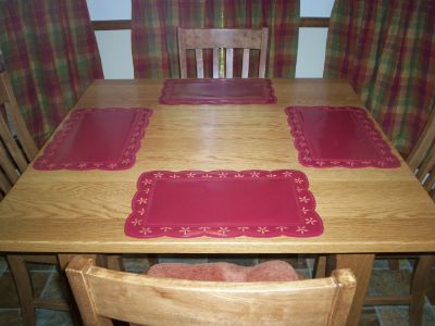

              Good morning gwyneth...
              Oak is open grain.. very open grain. The way to fill the grain is with paste filler which comes in light.. dark. natural. Natural can be dyed to best match the color of the stain or effect you want. And yes.. it is a process in itself of filling it.. letting it dry enough to scrape it.. then another filling if necessary. After completely filled.. you sand it to get any excess off of everything else but the pores you filled before proceeding with stain.
              You can use paste to get contrast on purpose. If you wanted a zebra-wood (striped) look on white oak.. you would just use dark paste instead of tinted natural or light as normal for white oak
              But.. you want the natural color to come through! That would be hard to fill without getting a definite un-wanted contrast to the filler. You basically fill when you want a very smooth.. glossy look as in "more formal". I don't use poly except in kitchen and bath furniture where I need a very hard surface and one that will keep the most moisture out.
              Below I will show you a picture of a recently done break-fast table and chairs in the country farm style my wife loves at this point in life. Being an "in-formal" design.. but I don't want deep open pore spots you can physically feel on the surfce So.....
              I chose poly for the hard surface in a kitchen and it's moisture barrier. I lay the first coat of oil base ( I want the amber glow it gives to natural) relatively heavy and basically un-cut as the frist coat is nothing more than to fill the pores without coloring to see them but give a smooth flow of the hand being run across the surface.
              Let it dry completely for a day or so and sand it so that there is nothing left but the poly in the pores. If they didn't completly fill.. re-apply and sand again. Once you have filled the open grain with poly.. you can apply a second cost to cover and I use a 70%p-30%ms mixture of wipe-on I brew in a clear plastic kitchen bottle. Let it dry completely and then sand it with 400 wet paper with mineral sprits as a lubricant.
              Now the real finishing begins with wipe-on poly cut to 60%p-40%ms. After each coat I let it dry completely and then sand with 600 wet with MS as the lube again. This will at least get 3 coats of top finish and could be as many as 5 more coats (the table has 5 added after the intial two coat to fill and cover) depending on how hard a surface you want.
              That's just how I do it and will let the results speak for themselves and you can form your own opinion if you might be interested in using the method as it has been long established that I am a much better mechanic than beautician!
              Regards...

                Wow. Great info, and thanks.
                Cabinetman, I know there's no specific answer to my questions (they were pretty open-pored themselves)...and you did a great job telling me more.
                Sarge, that is one beautiful table--you're being modest.
