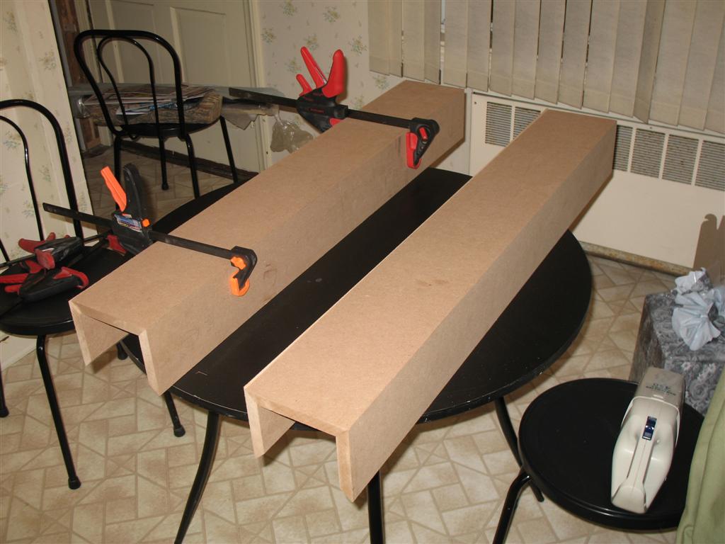

                          Just curious. Why not just miter the edges? No "rough" edges to cover. This was my concern when building my fireplace mantel - that the gap of a butt joint may show through over time due to settling, shrinking, change in temps, etc... especially being painted white.
                          Good luck,
                          Greg
                          Click to enlarge to see the edges

                            Originally posted by Stormbringer
                            The other suggestions should help you out.
                            Indeed an elegant solution, am not sure whether my skills with circular saw will be this good, but will try it with a straight edge next time.
                            gychang
