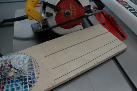

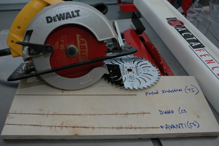

      For kicks, when at Lowes today, I picked up a Frued 7 1/4" Avanti blade ($20 & SHINY!)to see if the problem was my blade. I made a test cut with my Diablo blade (the one I had problems with this weekend), then tried the Avanti, then took the piece over to the TS. See pictures below for cut results (can you tell I had some free time today! ). Obviously there is no question the TS blade was far superior...but it looks like I'm getting the same results from the Avanti as with the Diablo. Granted, you can tell I didnt use a straight edge on the CS cuts...but got a good amount of tear out on the top of the plywood, then if you look at the second picture, almost none on the bottom. I do remember dropping the saw a couple of months ago...wondering if maybe the arbor bumped slightly out of alignment.

        Gary, I use the Eurekazone system, and get cuts like your tablesaw. But that is a fancy method (with other tricks) of an old method. From the looks of your pics, your not using a zero clearance insert on your saw? How about one on your circular saw?
        The old trick was to use a piece of 1/8" hardboard (last person I saw do it, used thin plastic) over the front of their circular saws blade. IT DOESN'T completely cover the opening, OR YOU LOSE YOUR BLADE GUARD (not safe). I believe they mounted it so it was about even with the arbor, then placed a strip on the rear metal piece of the baseplate.

          I'm not certain what you're getting at here, but ... you do realize that with a circular saw, tearout occurs on the top, whereas on a table saw, it occurs on the bottom? The difference is due to the direction of blade rotation relative to the workpiece.

            Thanks Larry - yes, I guess when I think about it for a second (duh) that explains it...although not so concerned about the diff between the top & bottom (shouldn't have mentioned it) - just curious why my CS cuts in general are so crappy.
