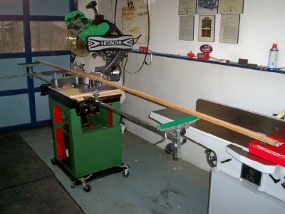

                I'm going to add my $.02 worth a little late, but what I am going to say will not be too late, IMO! Unless.. unless you have adequate friction tables built around your TS... DO NOT use it to cross-cut long stock, especially long stock that has just been brought into the shop from the supplier in the rough!
                If you use a BT-3 saw.. that slider that can be used for cross-cutting is not robust enought to abuse with that kind of wieght and friction it will be subjected too. It's great for smaller stuff, but it ain't no Felder slider that is designed to handle the "big stock".
                I have done it.. I will never do it again. You are dealing with a ton of weight on a small table top. You are dealing with friction when moving the stock forward on a mitre fence. You are preforming a juggling act as at a circus that carries some of the risk as a high-wire act.
                The first time I had a long piece of stock drag and twist into the blade pulling my hand toward the blade and literally lifting my body forward.. I found a better way. My hands were kept over 12" from the blade and I was not hurt fortunately, but a valuable lesson was learned.
                I immediately shut off the saw and went and purchased a 12" x 12' piece of yellow pine that became my cutting board. I built an over-head fence in the center to guide both outer edges of my circular saw over-head. The stock to be cut was simply placed on that piece of cutting board an slid forward to the cut 90* cut point of the circular that rode overhead. The cut board sat on 2 portable saw-horses and could be taken down and the whole thing stored on a wall taking minimal space.

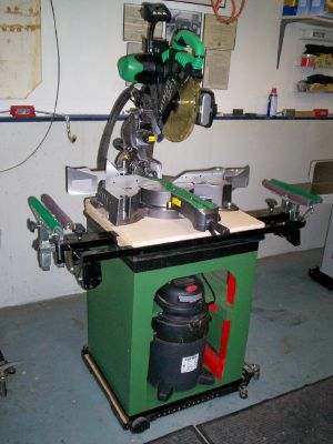

                Latter I purchased a SCMS and found a way to make it take minimum space but be capable of long stock support for the 12'-14' stock I bring in to cut to working sizes. I also use it very accurately to do All cross-cutting leaving my TS to do what it was truly designed for.. to rip. A also do any angle cutting in the SCMS.
                IMO.. cross-cutting long heavy stock should be done with a circular saw with support, RAS with support.. SCMS with support.. or a larger Euro slider and even then with proper support for long, heavy stock as you got your hands full and if you want to keep them.. and not over-tax your machine to the point it becomes very dangerous.. very dangerous indeed!

                  sarge, nice scms and cabinet. i like the setup. did the cabinet (with the opening for shop vac) come with the scms?
                  the more i read posts on this site, the more i feel the need for a scms and bs!
                  omar

                      "sarge, nice scms and cabinet. i like the setup. did the cabinet (with the opening for shop vac) come with the scms"?... omar
                      Naw.. it came from the scrap bin of construction grade 2 x 4 yellow pine and scrap bin of 3/4" MDF. I prefer to design my cabinets and bases the way I want them to meet my and my machines needs instead of what someone else feels I need and goes to market with. In other words... I'm picky about my machinery and one cheap "mutha" to boot! ha.. ha...
                      The extention wings are the top a portable Wolfcraft portable mitre stand I bought at HD when they were dis-continued for $49. O threw the legs away as they took up too much space and they gave me no mobility. That is just a 2 1/2 HP Shop Vac on sale for $24 from Lowe's turned back-side to face the hose out the rear. Took off the bottom casters to reduce hieght and it it strapped in with a piece of Velcro for quick removal and emptying.
                      About $75 invested total.. but $75 well spent as I see it as I got exactly what I ask for from the git-go without having to mutter... "I wish they had thougth to put a .......... :>)

                        COOL! the green paint and i couldnt see the thickness of the base trew me off
                        omar

                          BTW Sarge that is a nice set-up!

                              Thanks for the comments on my SCMS set-up. Just part of a labor of 35 years love of this hobby and what has evolved in my case from day one to the present. If I could go back and start day 1 in 1972 with what I have learned along the way.. I could have possibly become a decent Wood-Worker instead of a "Wood Butcher". ha.. ha...
