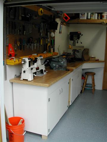

              I would be remise if I didn't throw in my two bits. I make my benchtops out of 2 layers of 3/4 MDF, covered in laminate flooring and trimed in hardwood. The result is a dead flat, very durable surface and hold up to bench dog very well.

                  scott: thanks for the picture, it really helps to see what you were saying! maybe one day my garage will look organized like yours.
