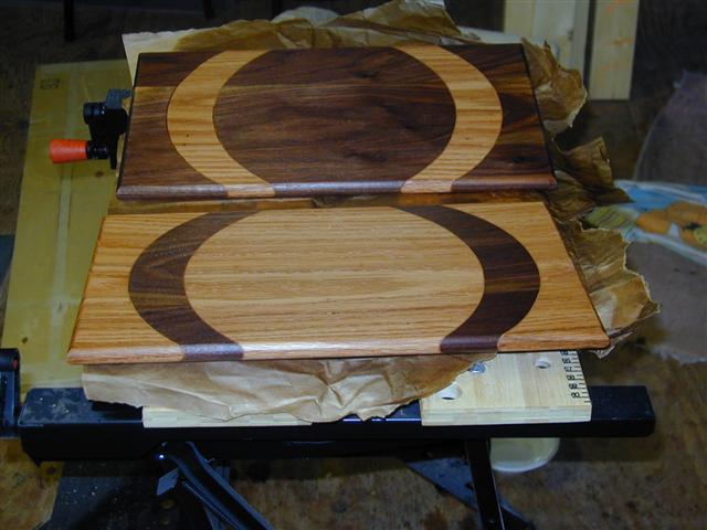

            There's more fun ahead when you do the glue up and the pieces start slipping and sliding away!
            I'm on the side of the isle that believes although end grain boards are best, long grain cutting boards work fine for normal home use. I've had several of these in use at family and friends homes and they are performing well, no problems with grain tearing or contamination.
            They are still not a walk in the park to make, but are less tedious than end grain ones.
            These are Red Oak/Walnut
            ken
Name:	Walnut_Oak Cutting Boards.jpg

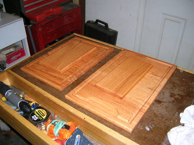

              Over the 2006 holidays I tried my first effort at some cheese and cutting boards as gifts for the kids. Used some red oak I had left over. The lessons learned here included horsing my plunge router around. This was the first project where I used the plunge base. I discovered that it takes a lot of practice to use this thing right. Every one of the boards had some problem where I lost control. So - next time I do this, I hope it will be better. I didn't even attempt the end glue thingy - they've done fine for home use as Ken notes.
              Ken Weaver
