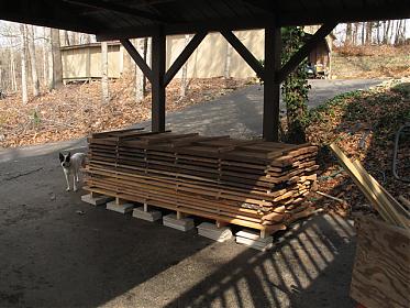

    Ok guys, I went back over and got at least a small load. Maybe 220-230 board feet.
    They didn't have much cherry but I picked up what they had, about 60 BF. About 60 more board feet of maple, some 4/4 and some 8/4. The rest was 5/4 and 4/4 walnut.
    The walnut had just been cut so I tried to get that stacked first. I have a separate building that used to be an apartment so the rooms are not heated or cooled but they're at least insulated. Am I better off trying to dry the wood there where it stays at least 40-50 degrees or would I be better making a shelter for it outside where I'd get some air circulation ? Would appreciate your thoughts on that.
    Man it takes a LOT of stickers to stack this stuff properly. Whew.

    Guys, any thoughts on stacking wood outside vs. inside for drying ?
    Warmer and dryer inside but I'm worried that stacking inside won't provide any air flow. Should I try some kind of fan just to get some air moving there ?

      Yes, good airflow is key, so outside -- but under cover, somehow -- is usually better. Stack it nice and flat and keep the rain off, and it'll do fine.

          Last year in March I had a miller drop a walnut, cherry and tulip poplar on my property and he delivered me 1100 bf a week later. I asked him for stickers too and he sold me a zillion for $20, all ¾ white oak. I started to stack it and then turned the job over to 2 kids I had working in my yard. As they got to the end of the second pile they started to run sort of stickers. I weighted the whole stack down with ceramic tiles
          It showed 6 months later the ones with less than full length (IE part of the width of the lumber was cantilevered out 2-4”) now has a cup to them. So be very diligent when placing your stickers place them right above the row below or you will get wavy boards I did mine at 18”. They lumber was out of the direct sun and rain. I need to go and check the MC but it was 9-11% last fall.
