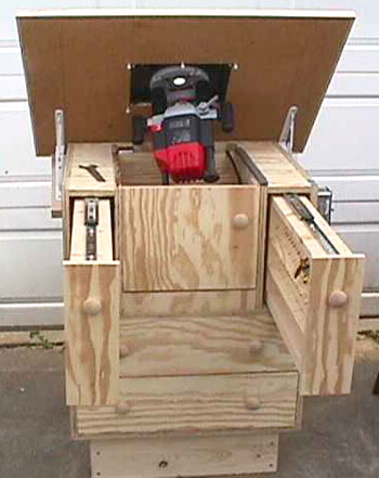

                            For the top I used some bar top that I had salvaged, I also eliminated the casters since I wanted it in a fixed location. Additionally I made the top a tilt up which I love for the ease of setting bit height. Here is a photo of it before I painted it.
