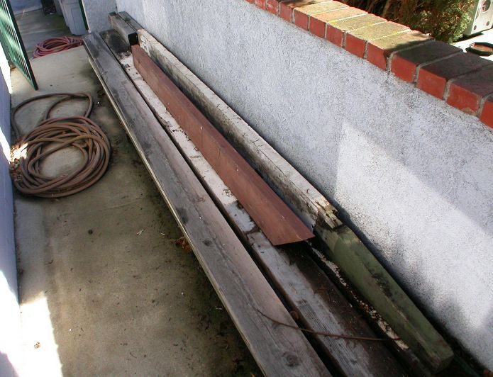

    Saw this ad on CL and was wondering how hard it would be to recycle the lumber below. What would I need to do. I figure I'll need to plane it but should I do something first as to no dull out my blades so quickly. It's pretty beat up at least the surface seems so. Is it even worth trying to recycle it or should I just stop being so cheap and just go to the lumber yard ?
    From ad...
    " App. (6)3x8x20, + additional 100' of 3x & 4x material of varied lengths, all smooth 4 sides, Doug Fir, #2 or better, some rot.
    Stickered, but stored outdoors for past 7 years, great for shoring or resaw for trellis stock.... "
    -Paul

    Fir is pretty soft (similar to pine), so I'd probably just brush the dirt off with a stiff brush and send it through. The only thing I would be concerned about is how much rot there is. Too much and it might not be worth the time, let alone money.
    Lakota's Dad
      Get a metal detector There are probably a lot of nails in it.

        I wouldn't even think about trying to sell something like that. If I didn't burn it Id throw it out. Maybe I throw to much away. I try to get rid of a truck load of junk at least every few months. I don't know where it all comes from.
          Just from the pictures, I would pass on it.
