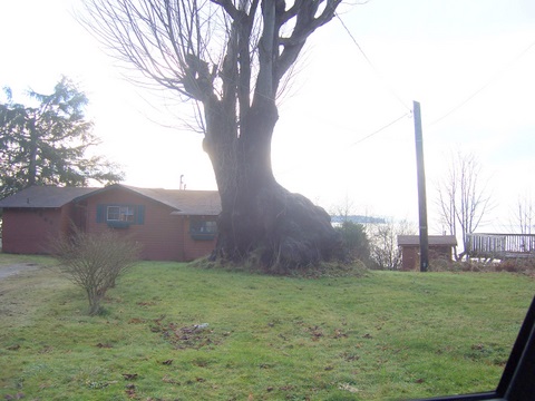

                          Ah, must be a neighbor of mine. It is frustrating to no end to see how many maples get just cut up and chipped cus they are a nuisance. And then to go to Windsor or some place to buy wood and see they want $6-$7 /bf for maple.
                          I have a few trees coming down right where i live tomorrow and I'm trying to track down someone who saw them up for me. If I can get a few logs that is A cluster of 8 maples from 6-12" diameter and a horse chestnut about 24" across.
                          There is a tree right near here that must have the most amazing burl, it's nearly 10' (feet) across and it's just one GIANT wart. I should take a picture of it someday.. I have dreams about being able to cut into that tree...

                            Took a picture on my way back to work from lunch today.
                            kinda bright out so it's not the greatest, but you get the idea..
                            How would you even work on cutting up (or down) a tree like that?

                              Had this discussion with friends recently. Their advice was to borrow or rent the largest chain saw you can manage. If you're a member of a turning club, invite friends! There's enough there for several turners to benefit from and for several turners to make short work of.
                              General consensus is to keep the wood in pieces that are as large as possible. Less potential for checking that way. Drown the ends in Anchorseal or your sealer of choice. Cut off what you're going to work on and reseal. For the burl, cut it into manageable pieces unless you've got some particular project in mind. Natural edged tables?? Kind of like what they used to do with cypress butts?? Could really be beautiful. Nested bowls means that you cut pieces that you can comfortably and safely put on your lathe.
                              I can hear drool hitting the floor all across the country!
