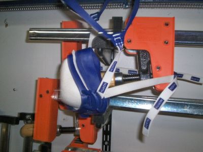

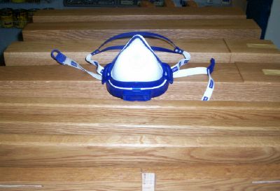

      Morning Ed...
      I used to use the Dustfoe, but they went south and the filters are no longer availabble. Purchased a North CFR-1 with 20 filters for $29.99 from Highland Woodworking. Additional filters are 20 @ $19.99. www.highlandwoodworking.com
      This thing is light and has the best strap on it I have used in 35 years. And the good news is it doesn't have the tendencuy to ride up and displace your glasses or fog them. I wore it 8 hours yesterday sanding (ugggh) and them switched to an Advantage 200 vapor mask for getting gel stain on. 3 hours more or less in that one as a standard light-weight dust mast won't stop vapors.
      The advantage is an excellent lightweight mask, but I wish it had the rear release connector the North has. You have to stretch it over your glasses to get it on initially. Still.. I won't work vapors without a mask equipped with the organic filters. The mask you have is similar to my Advantage.. just make sure that the filters are organic for vapors. Some mask as that have filters for dust and a different set for vapor.
      Again.. I am absolutely happy to find the North and light-weight design that is a good fit with glasses I also have to use to see detail.

                        I had never seen the Coolmax mentioned either. I googled and found it at Amazon. Very similar to my old Dustfoe. Looks light-weight, but the face looks kinda small for use with a beard. And that might not be so as I seem to remember Paul mentioning in a thread from a while back that it was OK with that added to glasses.
                        Here's the North which is also OSHA N95. What I like besides no fog and good beard fit is the plastic strap support on the head and it continies on to the fasteners to become the back of neck strap support also. Two quick clips allow you to put it on with getting tangled in glasses. It fits better than any I have tryed (have not as mentioned tried the Coolmax). You can get in on and off very quickly which is a plus for me..
                        Whatever you do... wear something. After sanding 4 large table legs and strechers yesterday from 120 grit to 220 grit with a fan behind me blowing it out an open shop door and a shop vac hook-up to the sander. I didn't notice any dust directly.. but when all was said and done, a dust film was everywhere forward of the fan. I blew it out as custom by opening doors and starting in the back of the shop with an electric leaf blower. It had rained previously and my Dakota pick-up got coated from that. ha.. ha...
