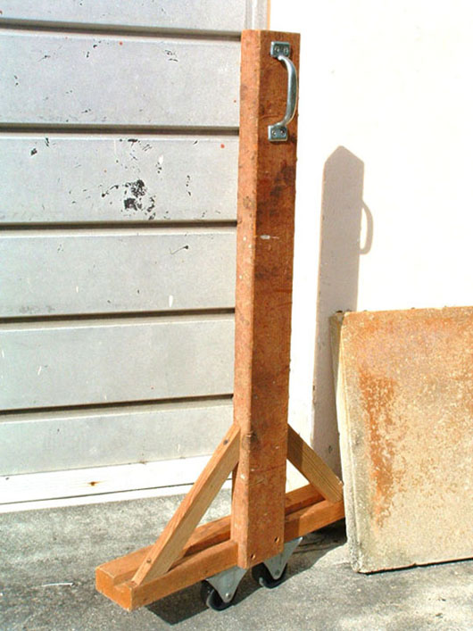

      I made a carrier similar to this one. Can't get to in now, but tomorrow, I'll take a picture. Mine is easy to make. The bottom piece is just a 2x4, about 24" long, with a 1" dadoe about 1/2" deep, full length. Underneath two fixed casters in line. The handle is just a 2x4 about32" long with a gate pull on the side.
        This is my shop made carrier I was referring to. Very simple to make.

          Perfect. Thanks Cabinetman!

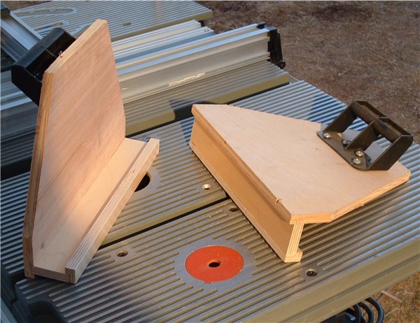

            Made a pair of these with the plastic handles that were on the french door when I bought it.
Name:	Panel Carriers.jpg
            They help, but still a lot of work!
