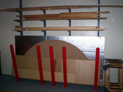

    If you haven't got this answered before I get home from work later to-nite mack-mack, I'll get you some digital pics of one of many ways a lumber rack can be made.

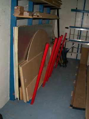

    I store lumber on the top shelving of mine and sheet goods on the bottom standing on edge. The base has a 5 degree angle that slants back to the wall and 3 upright runners in the front slanting slightly outward. The sheets are simply slid out the end when needed.
    Your rack has to be designed in a way that is complimentary to your existing space. That's why I mentioned that that are in-numeral ways that it could be designed. In other words, you take what you got and make it the best it can be. ha.. ha...

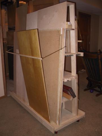

      It's simply any kind of rack, or shelving, etc. for storing lumber.
      I made one that's mobile, as many do, sized to fit a certain space I had, and to store mostly sheet goods.
Name:	Lumber Rack - In.jpg
Name:	Lumber Rack Safety Chain.jpg
      I think sheet goods are best stored on edge (off of concrete, etc.) at a very slight, or supported angle, for ease of access, and for good use of space. Be sure to have some safety measure to keep them from tipping -- a single sheet of mdf weighs 100#.
      Anyone making a mobile rack, consider that this could be the largest load you ever put on casters.

              Just got some pics of my wall rack. I usually don't store for long to avoid taking up too much space. I use a variety of woods and am not usually looking for mass purchases on bargains. White oak for a country kitchen table that just came off the rack is on the floor in the front ready to move to the forward shop for planing and demensioning.
              The base on the bottom is angles toward the wall and I have protective rails angled out to avoid sheets tipping forward as Tom mentioned. Simply slide emout the end onto a porto sheet roller, even though I work for the most part with solid stock.
