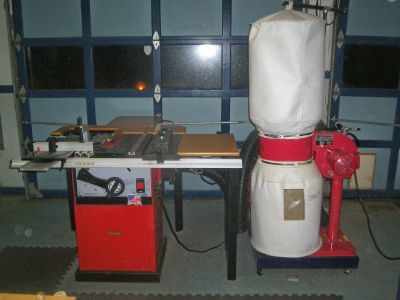

                I wear a mask.. I also open the door behind my TS and place a 24" cage fan on my worlbench facing the saw and out the door when I cut it. The DC is also connected to the rear port. And when I'm done, I take an electric leaf blower and start at the back of the shop. Again wear the mast and blow the whold thing out with all doors open and go up for coffee. Give all time to settle and back to work.
                In the picture below visualize a 24" fan on the workbench behind me facing the saw and out the open door. Very little gets a chance to permeate the rest of the shop. Second pic is my router table. Top and base made of guess what? MDF.. of course. Table top edges are sealed with a band and 3 coats of poly under. Top is sealed with Mica. .002 movement in 4 years. Very useful stuff. Just wear the mast as you should with all dust particles floating around.
