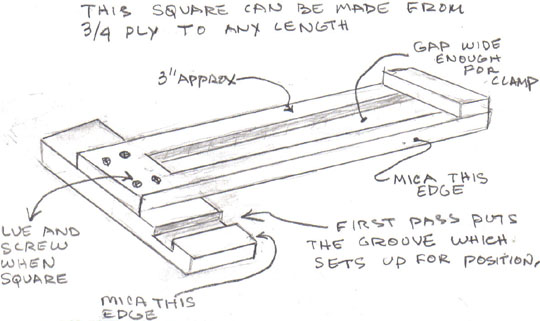

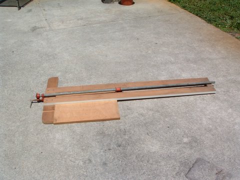

              When I was young like you and broke, and didn't have a RAS, I simply made a crosscut jig for a circular saw. It's a lot like the attachment, except for it dedicated to a circular saw, not a router. Oh, the one pictured does real fast easy setups for routing dadoes. The difference being that for the saw, the first pass will cut off the right leg of the jig to exactly where the blade starts cutting. You could even make the pass at 45 deg if you want. Heck, they are easy to make. With that, put your mark on the moulding and simply run the saw over it. BTW, you may not need to use the clamp if you can get a good grip with your free hand. This jig is for a right hander (that could be you). I forgot to add that the long part of the "T" doesn't have to be split for the clamp, that is your disgression. The one pictured will accomodate a four foot dadoe.

                Cabinetman
                Thanks!!! I think that will work just fine.
