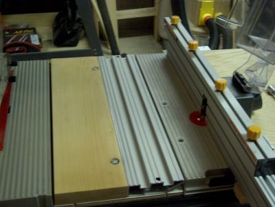

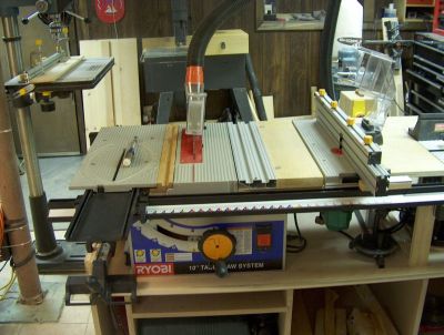

I picked up the BT3100, the Ryobi 2hp plunge router (mounted it in the BT), and a nice assortment of router bits. I've borrowed routers and have done some limited work with a straight cut bit and a clamped straight edge, but I know there is much more to it.

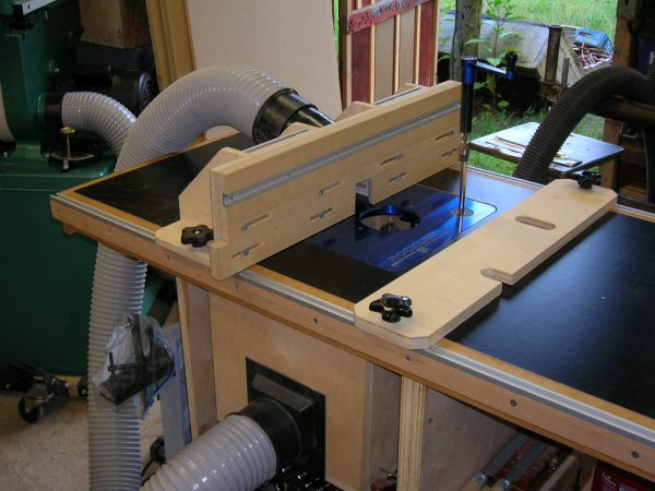

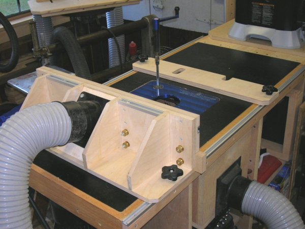

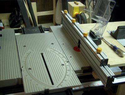

2. Fence options. Without exploring manufactured router tables and conventional fence positioning, I first thought of using the BT3100's rip fence in the same way it is used for tablesaw ripping. That is, putting the work piece between the fence and the bit. Now that I look into things (and various pictures on this site), I see that the fence usually has a relief cut in it that harbors the bit partially. In this config, the routing occurs on the side of the work piece facing the fence. I suppose it's easier to set the bit's reveal to the work piece in this manor.
3. Would a rectancular tube of aluminum make for a good router fence? I'm thinking it would be easy to t-nut mount it to the rip fence and being hollow, easy to adapt a dust port to the end.
