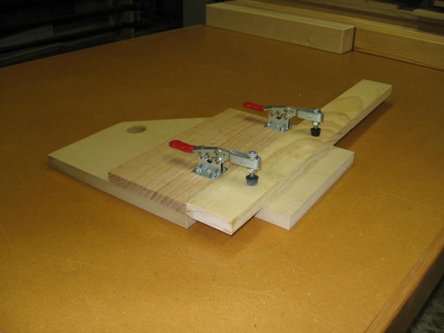

    A few days ago, maybe a week, I told someone I'd post some pictures of the homemade end-grain sled that I use on my router table. The name of that person and the thread in question have now escaped my aging and increasingly fragile memory, but if you're reading this, here you go:

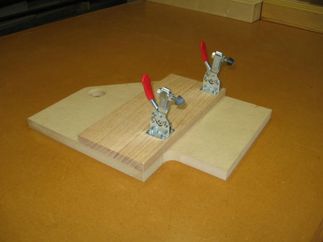

    The sled consists of a chunk of 3/4" MDF with a hardwood fence attached to it at right angles. There's a cutout at one front corner, for bit clearance, and a couple toggle clamps atop the fence.
    The workpiece loads into the sled by simply positioning it against the fence and locking down the clamps.

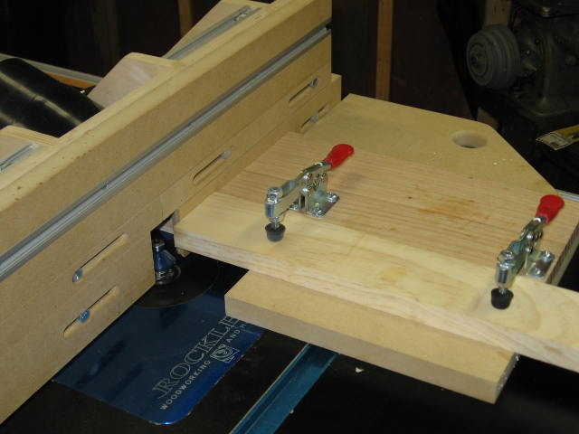

    At the router table, the long edge of the sled rides against the fence. Note how the bit is raised higher than normal to compensate for the 3/4" thick base of the sled.

    Larry, I must be missing something here... I've been planning to make an end-grain sled and yours looks great - but you don't show a sacrificial fence in the pictures. Surely the fence is going to get eaten up by the bit. In my plan I was expecting to have to insert a 1" or so sacrificial board between the stock and the fixed fence.

      Whoops.
      Good catch, Alan. I completely forgot to insert a sacrificial strip between the workpiece and the fence before taking these pictures (and hadn't realized it until you pointed it out).
