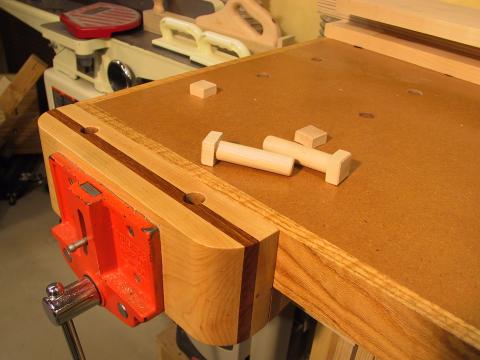

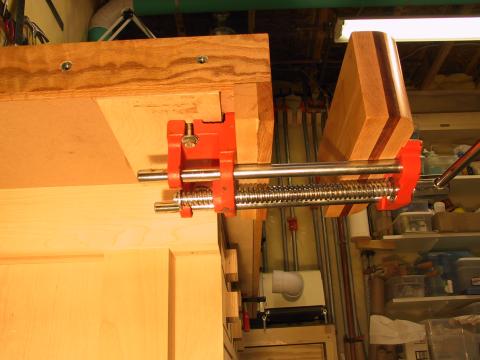

        I find it useful to have the rear jaw flush with the bench, rather than protruding like it was at first.
        In fact, I buried the rear jaw into the bench like so:
Name:	Vise - Under Side.jpg
        My vise is undersized, and due for an upgrade one of these days. So far, I like the Big Jorgy for its very rigid front face. My current vise requires a lot of "toe in" to counter its flex.

          Tom, I appreciate your posting the pics. They cleared up some questions and I also like the idea of putting a couple bench dog holes in the front jaw. The Groz does have the single pop-up dog, but I can see where having two there could be very useful.
