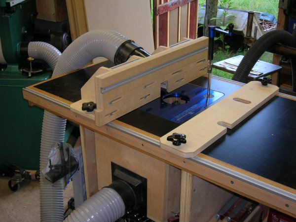

        Salty, don't put slots in your miter table top. I know it's a common practice, but slots will weaken the top and make it more prone to warping by giving moisture a place to enter. Instead, make the fence long enough that you can clamp it to the overhangs of the top, either with loose clamps, or pinch blocks, or vertical "ears" that attach to an edge-mounted T-track. Lot of ways to do this.

        EDIT: Here's a picture showing how the fence attaches on my router table, the ex-Otter "Ryoborghini." Note that the T-tracks sit atop and are fastened to cleats that are in turn attached to the tabletop proper. As you can see, the fence can be positioned anywhere.

          There are multiple ways of securing the fence. On my fence on the accessory table of the BT3100, I put a t-nut in the accessory table and the fence has a slot in it. On my router table, the ends of the fence have very short pipe clamps that clamp the fence to the table.

            LarryG...thank you very much. That is a great idea of clamping the fence at the outer edge. The fence would work great on a top that is 28" wide and that should be good for most anything I would need.
            That's a really nice table BTW. I am a long way from getting to that point in craftsmanship.

                Salty and WEG: I can take very little credit for what you see in that picture. I built the fence, and added the hold-down cleats and rails, but the table itself was built by forum member Otter. It's actually a wide table and mobile base for a BT3x00 (hence his nickname for it: "The Ryoborghini"). About the time I was setting up my shop, Otter switched to a contractor-type saw, did not need The Ryoborghini any more, and made a gift of it to me. Upon getting it home I quickly discovered that I did not have room to set it up for its intended purpose, so it became my router table and thickness planer stand.
