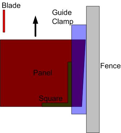

        Along the lines of what Mike said, I use a Clamp-n-Guide clamped to the workpiece like so:
Name:	Panel Square Up.jpg
        You have to cut off the "ears" of the adjustable piece, but that's no real loss.
        I use the 24" and 48" models for this purpose.

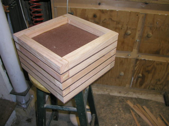

                I'm about to have a similar dilema with some artist panels i need to make .
                theyre masonite backed with a cedar frame.
                after glueing up i like to take 1/16" or so off each edge to remove squeeze-out and have a nice flush crisp edge.
                problem is i dont have long extension rails like some here, and this time the panels are 3'x5' !!
                i guess i'll have to use circ.saw with a straight edge guide?
                anyone have a way for ripping 1/8" or less against the fence? the edges are square enough ,just need to be cleaned flush..

                  Do you have a router? I keep a 4', 6', and 8' long melamine covered shelf boards around for this kind of thing. Clamp the shelfboard on top, and guide the baseplate of the router, or clamp it underneath and use a flushcut bit.
                  That's one way to joint long stock, too.

                        Before I got a clamp-n-guide, I used to just double-sticky-tape a framing square onto the panel, and let the edge of the square ride the fence.
                        Look for the stuff sold as carpet or rug tape. Not the stuff carpet installers use to join carpets, but the stuff for holding a rug in place on the floor.

                          thanks tom!
                          duh, why'd i didnt think of using a flushtrim bit
                          actually if i dont do that i might use this nifty idea i found in the 1'st issue of shopnotes(i found pdf's of ever issue)
                          they made a jointer out of the tablesaw by attaching a sacrificial fence,flush into the right-side of the blade,then adding a 1/8" masonite "outfeed table" into the backside of the blade,just past center.
                          i'd just post the pic of it from the pdf but didnt think it would be kosher here.
                          seems like it'll work perfectly as it gives a big flat surface(the tabletop) for the panel to lay flat on
